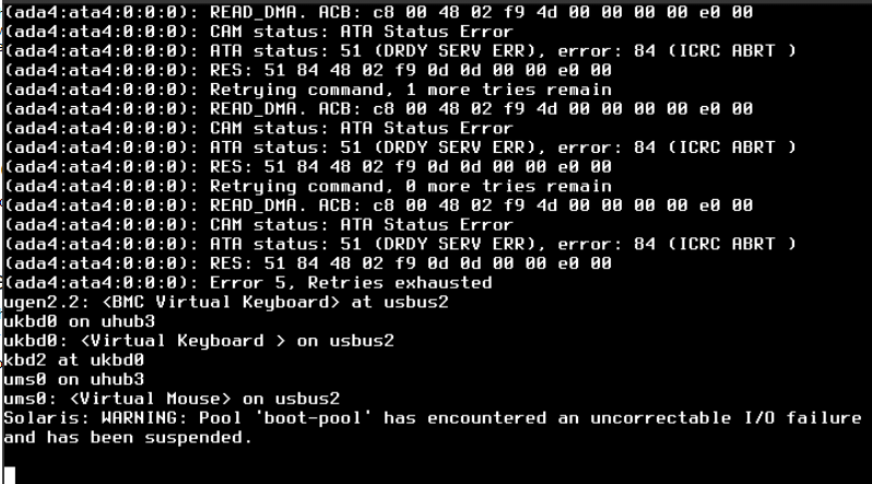

well... the drama is not over.
New integral drive lasted all of about a week before going awol again.
Seems on boot the drive is not detected.
I tried powering off and updating the bios via ILO and upon boot the drive was showing again.
I suspect more so due to the cold boot than the upgrade.
I would like to upgrade the SATA controller firmware but I think I'm going to have to used a Ubuntu live USB to do this.
Meanwhile I booted my install media once more and did a fresh install, This seems to go through ok but then on reboot it freezes on Attempting to boot from C: indefinitely...
Any thoughts? Can I be that unlucky with SSDs?
Are there any console commands i can run from the install media?

The issue seems to be happening so consistently across different drives make me think your problem is not the SSD's but maybe the SATA ports or even the motherboard itself. If you have a spare machine, maybe try to use that drive on a spare machine and see if it works differently. I understand this is a tough ask though.
Well, that depends on what you want to do, but if I remember correctly, the install media does allow you to drop into CLI at the end of the installation.

Those errors look like your controller might be the issue. Is it a port on your motherboard? Can you try a different port? different cable?

You can probably try to run smartctl on the drive through the install media.
