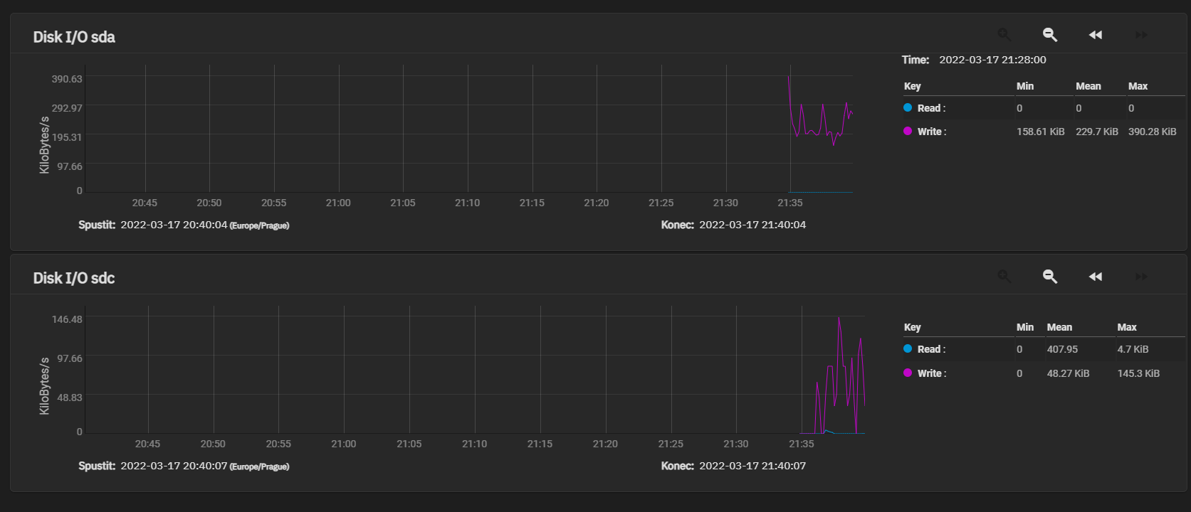

I have same problem as user "thereverend". Neverending write/read. In monitoring HDD is small data size.
UTB cable is disconected. System Dataset moved on boot-pool but not problem solved.
Any solution?
I have a Synology NAS nas QNAP NAS and these disks in Synology and QNAP NAS don't have this problem.
The disks are in RAID 1 (mirror) mode.
Fresh, clean install.

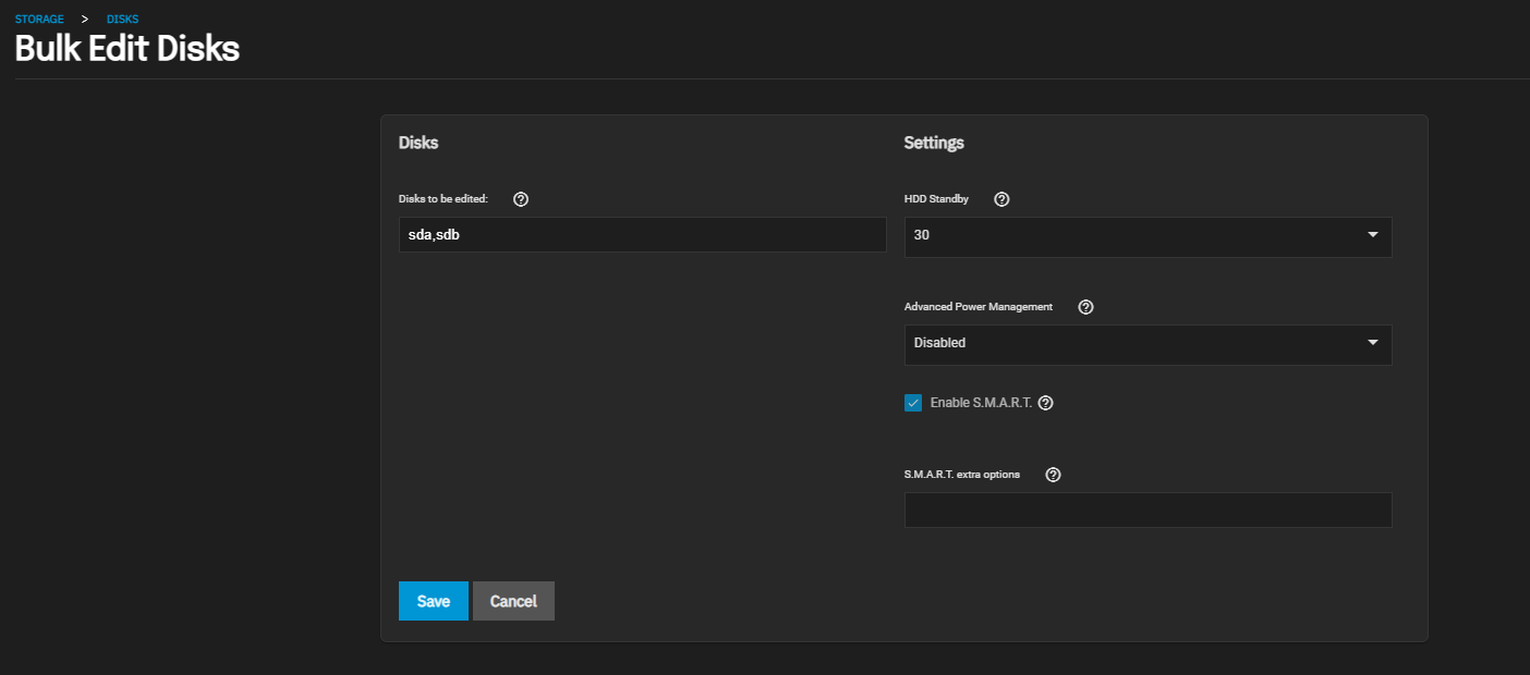

Due to this activity, I can't put the disks to sleep after xx seconds and diks keeps clicking or writing.
Tested on:
TrueNAS 12, 13 (Beta)
TrueNAS Scale 22.02.00, 22.02.01 (MASTER-20220223-015752), 22.12 (nightly)

I tried to connect a HDD with transparent glass (i used for physical monitoring) to the TrueNAS server to see what the headers are doing and it shows the same symptom (sound) as the HDD I have for data storage. The headers constantly park and travel to the stove. About once every 2-3 seconds. When I sent it to the manufacturer to be able to tell me how much the HDD wears out with this process, he wrote me that it would not damage the disc plates in any way, but what is more stressed than the normal diameter is the motor that controls the read / write head and in such a highly used way sees lifespan (read heads) of 1-2 years. If the header does not park but only "flies" in the space above the HDD, the standard life of the disk is 5 years.
If the disk is destroyed due to parking and read / write heads, the warranty also applies to this item and it is not a problem to replace the disk. But I think it's useless.
Would it please if this will be read by any of the developers to take a look at this issue in a little more detail?
The problem is that even if one buys NVMe M.2 cards and uses them as a cache, it also does not solve this problem and the disks "click" further. Paradoxically, the cache should protect the disks from frequent reads and writes, but this BUG wears them out itself, although it does, it caches data during normal reading and writing.

The drives are the new WD Red 6TB. I've already read this on the forum, but just that although there are so many posts on this topic, it's so weird that TrueNAS developers haven't solved it yet.
TrueNAS Scale is built on Debian. When I run pure Debian on the same server and install Samba (apt-get install samba) and configure smb.conf, etc.) it doesn't show this problem. So it will be something to do with TrueNAS.
I have already checked SMART and it does not show any problems. But I can get this information later.
I want to put the disks to sleep because I don't access the data on the disk all the time, but only occasionally. When I'm outside where I live, I go outside during the day and do other things than work with data on the server. If necessary, I will connect to it remotely via public IP, etc. And I would like to run services such as Plex, Web, etc. (which I can not now, because it would affect the monitoring of the problem). So most of the time, the work as such does not make up the data available for "shock actions". And at the same time I would like to create TrueNAS as an archive tool when I do not back up data to another NAS server but I would like to use a pair of disks in one server for live data and a couple of other disks using CRON from time to time and save data on them . Other NASs like Synology, QNAP, etc. can do this by default ... thanks to the fact that they work with hot-swap mode and SATA disks can be removed while the server is running. The problem is when those disks are unable to fall asleep. This then leaves thanks to the hotswap exchange very soon, because when the headers are just reading / writing, the disk will certainly be damaged very soon. If TrueNAS is published as Enterprise then I assume something like hot-swap removal and disk mounting should be the basis.
I think it's a BUG, because other NAS systems don't show such a problem, and also because even though I disconnect individual disks in the TrueNAS GUI with the "detach" command, they still work - the header still tries to park to read / write some data I don't know.
Unfortunately, I also failed to install any monitoring tools because TrueNAS Scale linux (Debian) is not allowed to install other applications (it has the "apt-get" command blocked and I also failed to install the tools from the manually saved DEB package). So I am not able to find out which file is currently being written or read.

The problem I described is not even a hint that I would decide whether or not to disc.
TrueNAS includes a feature that should allow Always operation, or turn off disk xx seconds after xx seconds. This feature cannot be used because ...
The problem I mentioned is that TrueNAS constantly parks / reads / writes the read / write head. And if that's how you write "normal" then I would also require a function so that it is possible to turn off this normal thing. I don't know of a single person who wants this "function". And I'm one of them.
I think that better than speculating on the individual hours of disk wear, you would (if you have the power) urge a solution to this problem. Whether in the Jira system or with your development colleagues.
And I would like you not to choose from the text I am writing to you. I'm not doing this to you either, and we're probably not kids or Russia and Ukraine to compete with each other. It is clear that if you select certain sentences, the context of the messages will also change. So please don't act like that. Thank you.
I would welcome a way to solve the problem. For example, to recommend me tools, commands with which I can find out which file or what data the read head reads / writes, or which application accesses the files. In my opinion, this will help to find out where the problem might be. If that's your interest at all.
Thank you

@truefriend-cz
You cut off part of the output, the part that states the hard drive make/model and is important to me, I do not need the serial number.
If that is the problem you are reporting then I would agree that it is a problem. I was thinking you wanted the drives to sleep for long periods of time. You need to ensure that the drives are setup as follows: HDD Standby: ALWAYS ON, Advanced Power Management: DISABLED, Acoustic Level: DISABLED, S.M.A.R.T.: ENABLED/TRUE and this should eliminate the drives from sleeping, UNLESS the drive is a laptop type drive where it will put itself to sleep constantly. I have my test NAS setup with old laptop hard drives. They work for testing but they park after a few seconds on non-use. It makes some of my testing slow but they do what I need and they were scrap parts. And you can play with these settings but look at the SMART report ID's 192 and 193 to see if the heads are unloading still.
As for your drives, the data provided indicated that your drives were powered off 272 times and that the heads remain loaded the entire time the power was applied. This means that the drives did not spin down nor unload the heads, both of which are desirable aspects for a frequently used NAS.
These appear to be new drives so I must ask, did you perform any burn-in testing on them? If not, I'd recommend you do this to weed out any surface damage and give you some peace of mind. If you do not, that is fine, it is just a recommendation.
A concern... You have had your hard drives running for basically 30 days power-on time and have cycled power to them 272 times. I have had my four hard drives for 3.5 years and power cycled them half of what you have done. That is a lot. These values could be the same because the drive electronics mirrors the head load/unload cycles in which case sleeping the drive (motor spins down not power turned off), or you really have cycled power that many times. A little investigation on the make/model of the drive would result in knowing if the two values mirror each other at all times.
If I knew the inner working of the TrueNAS application then I'd offer some advice. In the old days we would have the source code, modify it, and compile it. Anything good that came out of it would likely be incorporated into the FreeNAS. I have not done that in a great many years.
Good luck, hope you find the solution you are looking for.

My settings of the disks from first time:

So you have some good quality hard drives with a 5 year warranty. Again, I'd recommend you change your settings to have the HDD Standby to ALWAYS ON instead of 30 minutes. I'm sure that if you really want the drives to sleep, you will find a solution.
