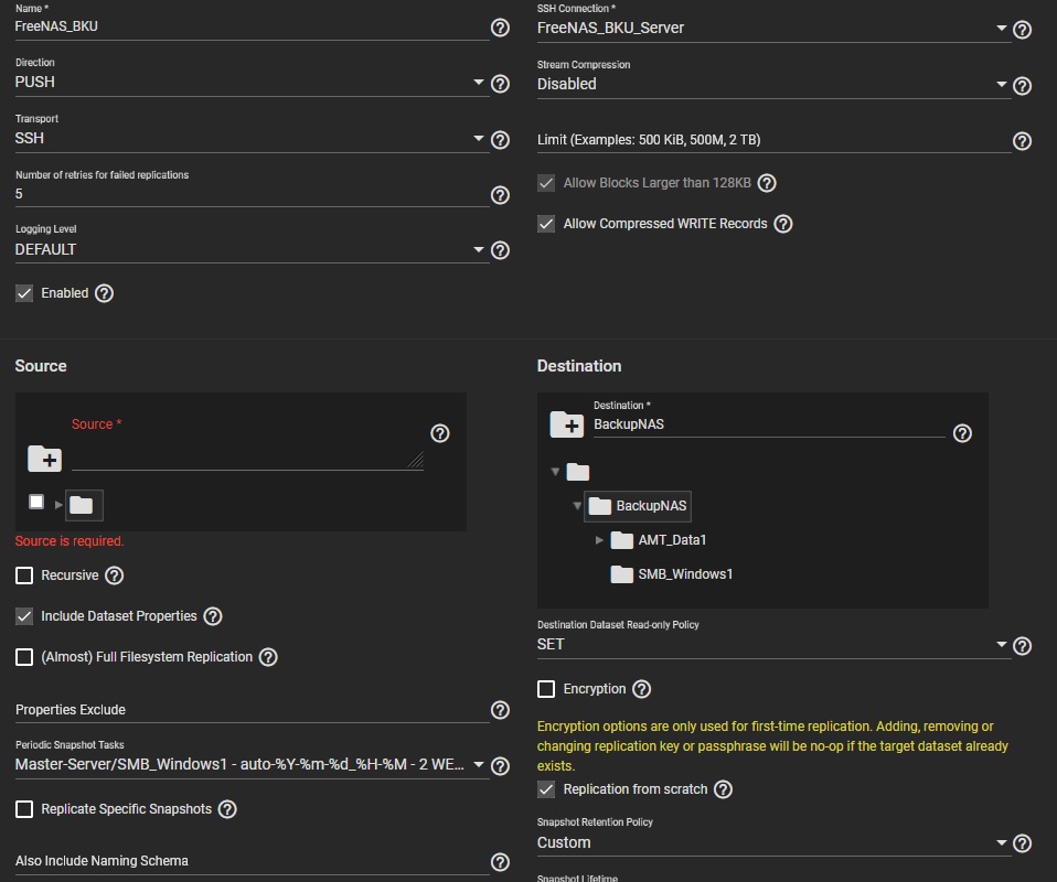

I have updated from 11.3 to 12 to 13
I have two(2) machines....Main and Backup both were upgraded.
The Main('Master-Server') machine is configured to backup to the Backup('FreeNAS_BKU').
The Master-Server machine is working fine as a data sever with SMB shares to many windows computers
I have not had any issues for years now while they were both rev 11.3.

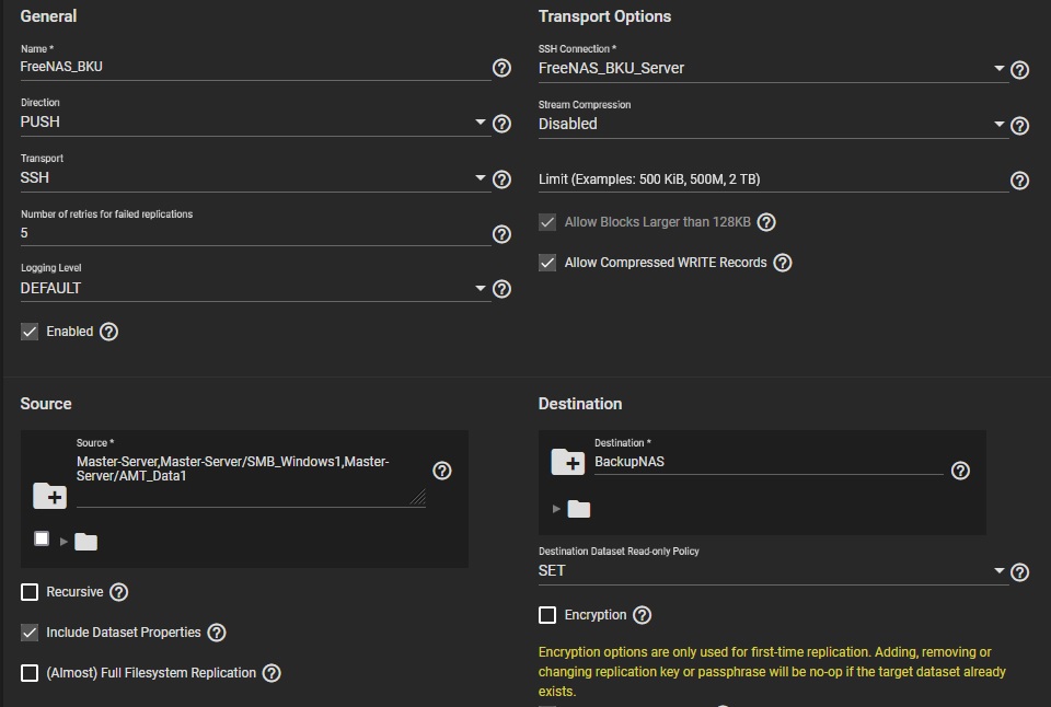

Now since upgrading... I get 'Replication "FreeNAS_BKU" failed: Dataset 'Master-Server' does not have any matching snapshots to replicate'
I have looked at the Replication Tasks,
I looked at creating a New Replication Task and I find that in the Source window... "Source Is Required'......clicking on the folder.....there is nothing to select from......
I also see that the old source path which has the letters SMB in the path are highlighted in RED.
The Destination window folders will open fine to select a path.
Any ideas here ?
Thank you

Are your screenshots showing the existing task or the new one you're trying to create?
What about clicking on the "arrow" next to the folder?
What do you mean? I don't see this in your screenshots.

It means the system can't find any snapshots matching the name that starts with "Master-Server/SMB_Windows1-auto"
What's the output of zfs list -rt snapshot?

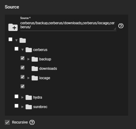

Sorry to hijack but I just got caught out by this.
I had to deselect the parent dataset (assuming that's what it is and not the pool name) to get the task to start.
But, one thing I did notice, if I expand "backup", nothing is selected underneath.
Not sure if "Recursive" will take care of that but I assumed "Recursive" could be applied to the parent dataset...

Okay, we good. Sheesh...

Found a couple of things...
Backup Computer did not update to TrueNAS 13....
Updated Backup computer to 13......
Still would not replicate unless option to Replication from scratch option was selected.
I also Had to delete the backup data set on the backup pc and recreate it before replicate on Main pc was enabled
Then it replicated - worked ok
Thank You

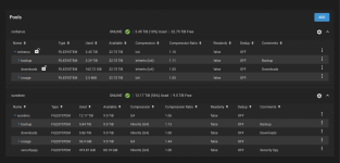

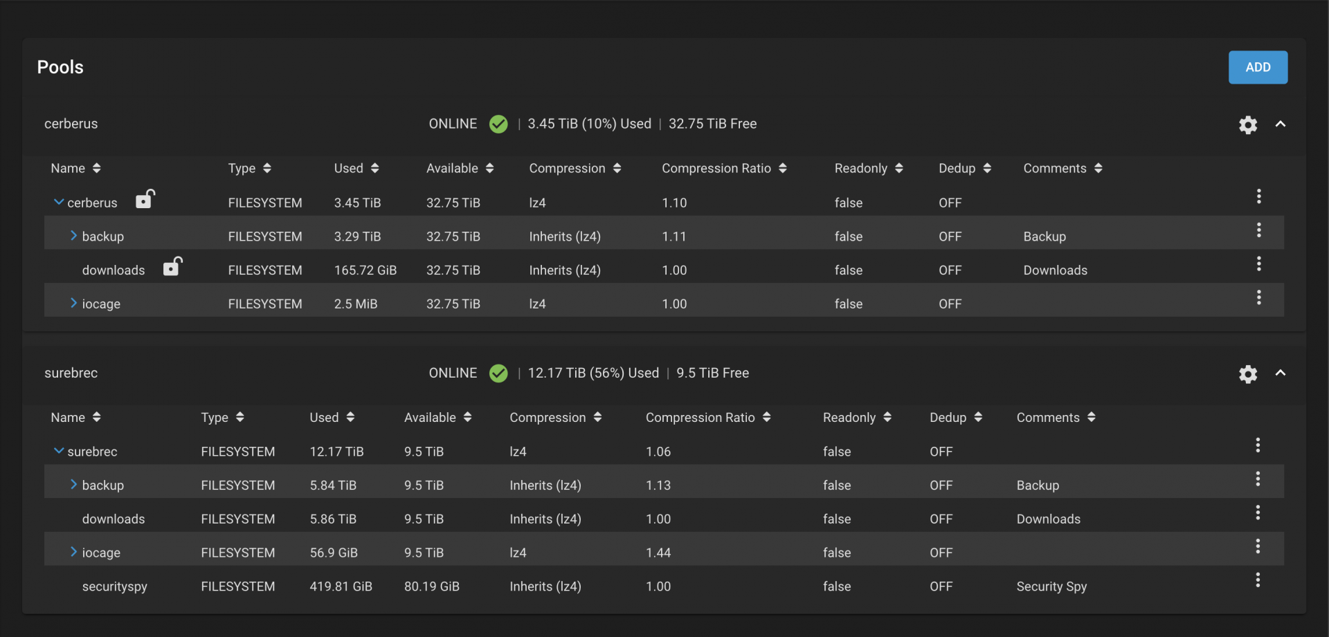

Gah, this is frustrating. So I've setup a new pool and trying to move data back.
Replication was successful to the temp pool but I can't do the same thing moving it all back.
When checking the snapshots, they're all listed. But when I try to replicate a dataset, it says there are no snapshots to send. I setup a snapshot task for the datasets I want to replicate but it's only moving the latest.
Also seems the replication task borked another dataset and stripped it of snapshots since the size dropped a couple of terrabytes.
I was replicating dataset to dataset though so not sure why this non-specified dataset was affected.
e.g. surebrec/downloads - cerberus/downloads wiped out snapshots on cerberus/backup
I moved 5.8 TiB yesterday and now it's down to 3.2
Is there a command I can put into cli to recursively replicate all datasets with their snapshots to the new pool?

Okay, I think I've got it now. After more research, I realised I can't send (or receive) to the top level dataset.
I was getting these errors;
zfs send -Rcv surebrec/backup@migrate | zfs recv -F cerberus
total estimated size is 5.80T
cannot receive new filesystem stream: zfs receive -F cannot be used to destroy an encrypted filesystem or overwrite an unencrypted one with an encrypted one
zfs send -Rcv surebrec/backup@migrate | zfs recv cerberus
cannot receive new filesystem stream: destination 'cerberus' exists

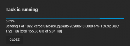

It's now churning through backup;
zfs send -Rcv surebrec/backup@migrate | zfs recv cerberus/backup
TIME        SENT   SNAPSHOT surebrec/backup@auto-20200618.0000-6m
Hopefully, once that's done, I can do the same with surebrec/downloads
