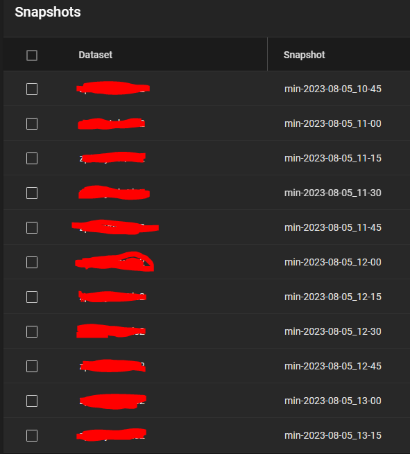

On source pulling I'm pulling from you can see the hour and min snapshots are being created
However on the destination I'm pulling to we only see the min snapshots
