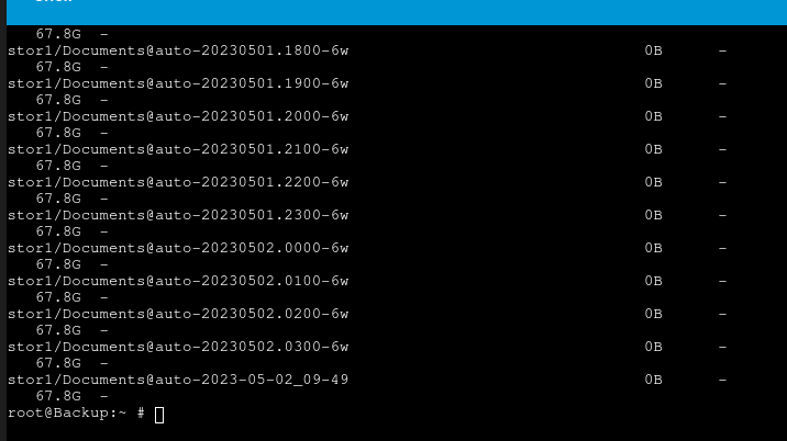

I have been fairly naughty as an admin, I've not really made any changes to the servers' settings since probably FreeNas 11 or so. My periodic snapshot name format is the old auto-%Y%m%d.%H%M as seen in the image below (a report of).
the last snapshot on the list is one that was created when I built a replication task through the GUI wizard to push the data from the backup server over to the main.

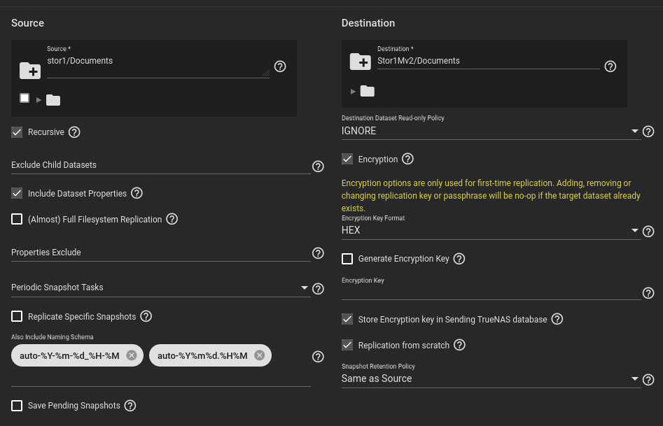

While this does, sort of, work, when I run the replication task (small snapshot below, the key's been removed for the screenshot), all that replicates is the very last snapshot.
zfs list -rt snapshot | grep Documents

I've tried building a replication task just for the older snapshots. I just get the following error:
[2023/05/03 15:43:03] INFO [Thread-42] [zettarepl.paramiko.replication_task__task_14] Connected (version 2.0, client OpenSSH_8.8-hpn14v15) [2023/05/03 15:43:03] INFO [Thread-42] [zettarepl.paramiko.replication_task__task_14] Authentication (publickey) successful! [2023/05/03 15:43:04] INFO [replication_task__task_14] [zettarepl.replication.pre_retention] Pre-retention destroying snapshots: [] [2023/05/03 15:43:04] INFO [replication_task__task_14] [zettarepl.replication.run] No snapshots to send for replication task 'task_14' on dataset 'stor1/Documents' [2023/05/03 15:43:04] ERROR [replication_task__task_14] [zettarepl.replication.run] For task 'task_14' non-recoverable replication error ReplicationError("Dataset 'stor1/Documents' does not have any matching snapshots to replicate")
To me, it looks like it doesn't understand the "auto-%Y%m%d.%H%M" snapshot name schema. Is there a way to push or pull them over into the new encrypted dataset?
