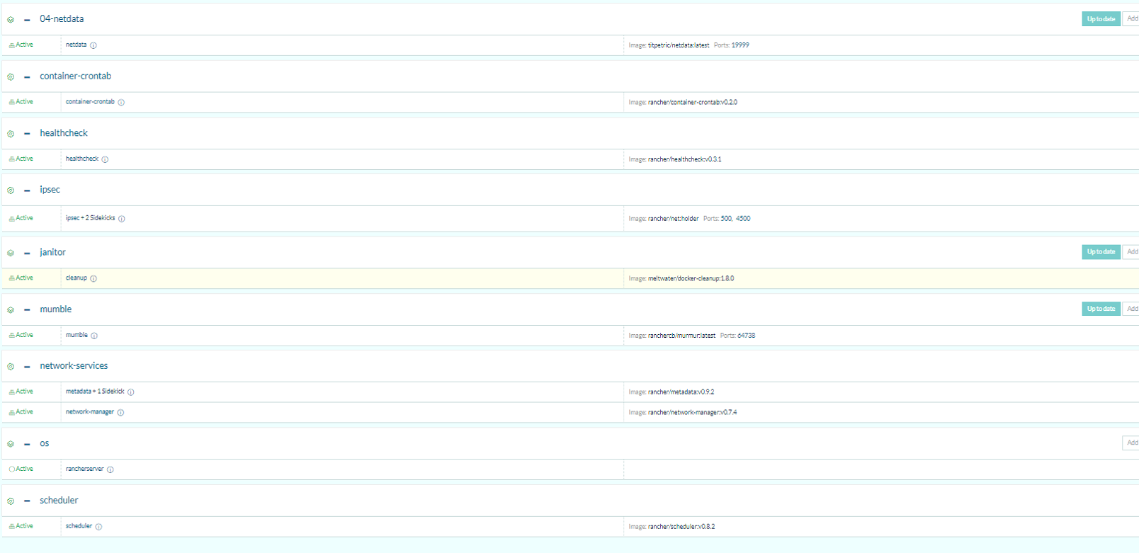

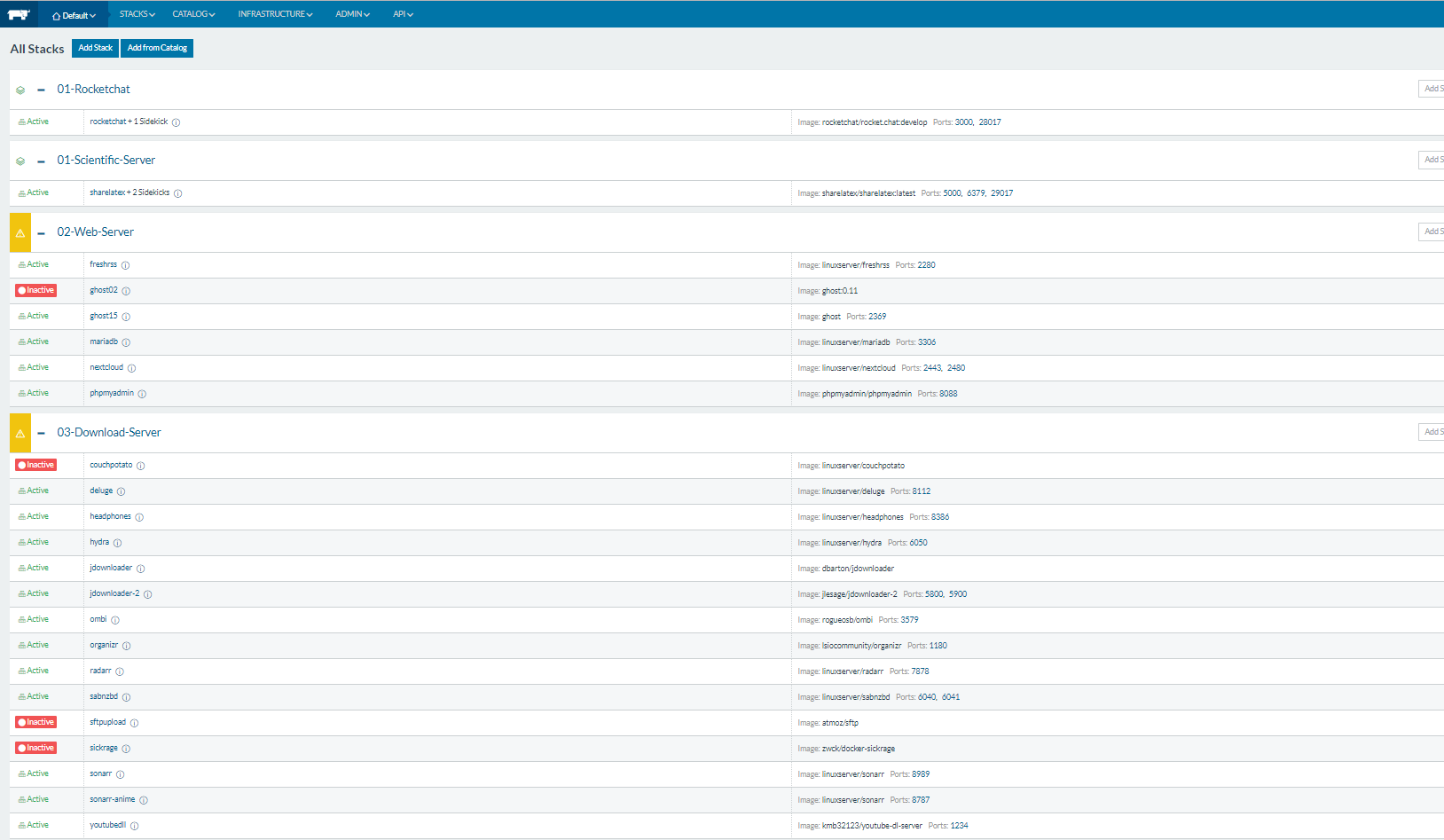

To my setup:
Terminology:
rancher -> GUI for setting up containers
RancherOS -> OS
rancher:agent -> container to give rancher administration rights on docker-machine.
RancherOS+rancher+rancher:agent -> bhyuveVM -> 192.168.0.16
UbuntuVM+rancher:agent ->192.168.0.17
The installed rancher:agent allows rancher to administer the given host. So i can administer as many docker machines as i want. So if you want to have certain machines that run at certain times you can do this from the rancher GUI, no problem.
What i am hoping for is that at somepoint (freenas 11.1 or 11.2) will allow setting up RancherOS through the freenas GUI so i can setup a couple of rancherOS-VMs via GUI and have one rancherOS just to administer the other VMs, basically a HA setup.
hoping to move everything but Plex into containers
This is exactly what i have done (except replace plex with emby)
These are just the containers for my RancherOS system, i have them scheduled to restart once a week, or depending on the container once a day. Some of them i start by hand some of them i have set to inactive because i wanted to try out alternatives, simple export of docker-compose and rancher-compose files makes it super easy to move from one host to another.

Here you go, there should not be any passwords or so included so its quite easy to share
