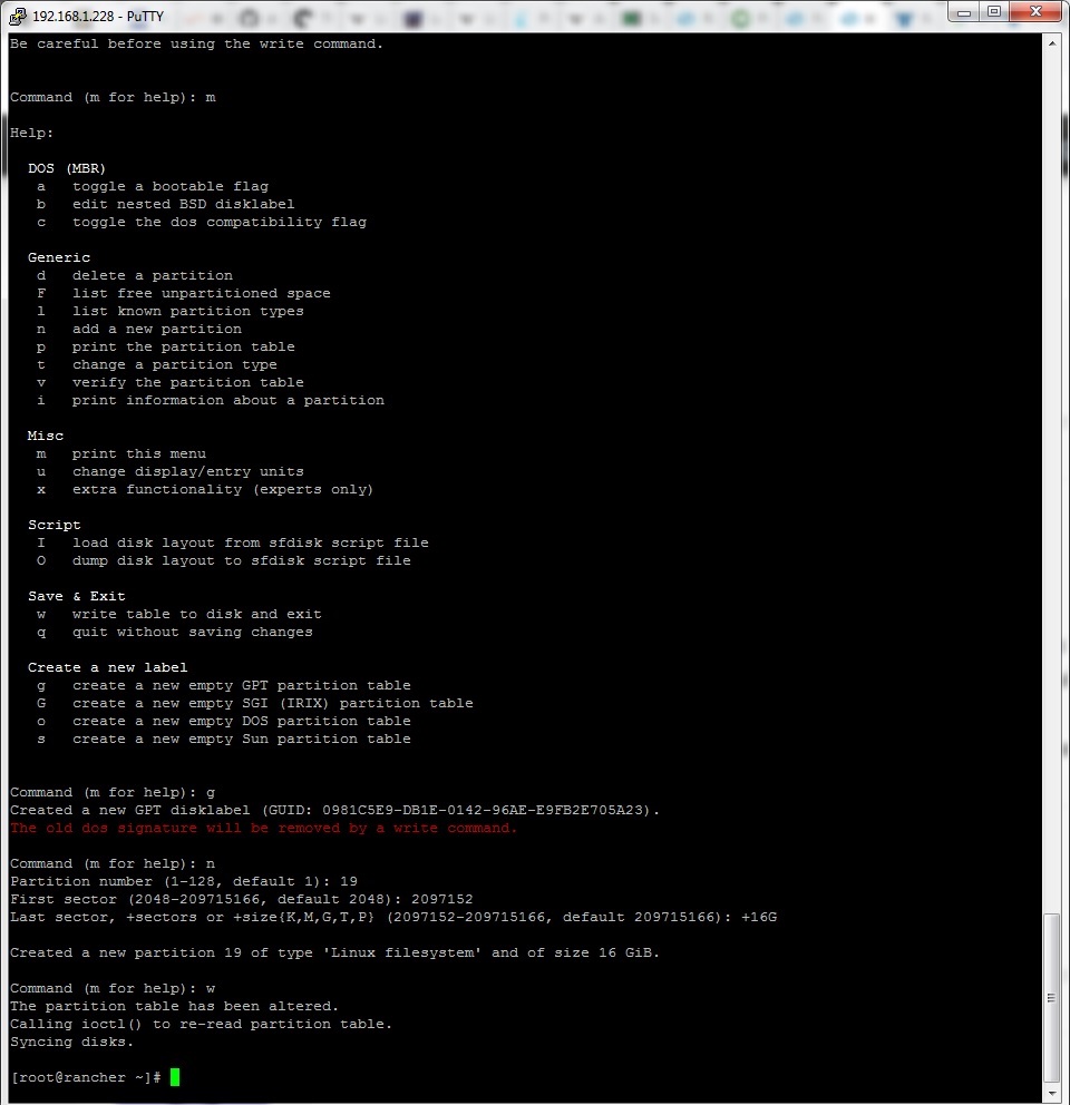

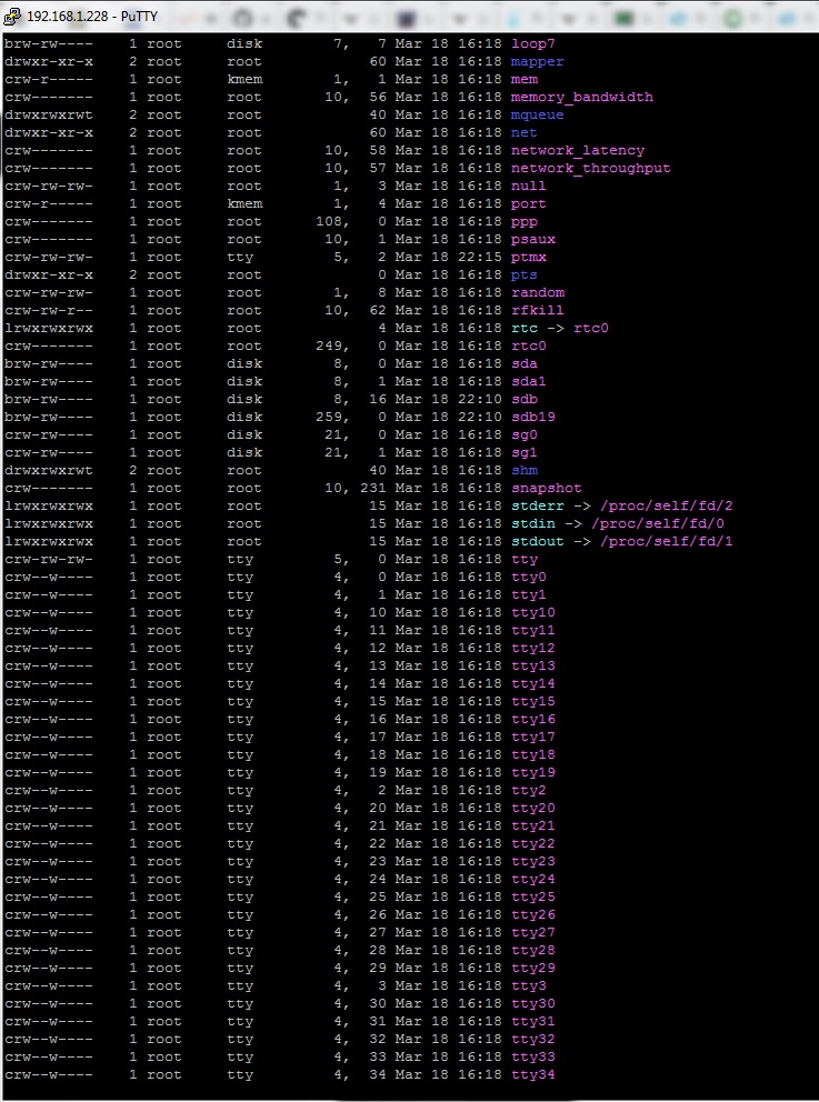

sdb and sdb1 are showing up now (see photo). I'm on Step 4 of your steps. It's asking for "First Sector". I'm not sure what that means. You mentioned the partition size but I just wanted to be sure.
I created the partition of 16GB (see photo). According to your step 6, which is mkswap -L RANCHER_SWAP /dev/sdb1, except I don't have an sdb1. The one I just created is sdb19 (see photo).
Is this the one I should be calling out?

Samuel Tai
Apr 24, 2020
5,399
Ah, you got it wrong. Run the fdisk again, and use partition number 1 instead of 19. The start and stops can be the same.

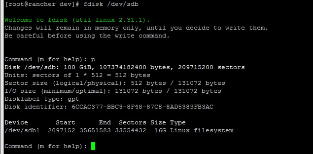

Here is the output of fdisk /dev/sdb, then p
I don't see anything about it being a SWAP partition.

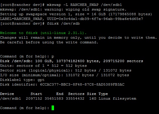

Run the mkswap again.
CookiesMonster
Mar 15, 2021
19
I still get the same output after I ran the mkswap line again.
I noticed in your Step 4 you say "Type n to create a new partition. In your case, you want 19, a Linux swap partition. "
I never saw a prompt to set something to "19".
Was that some value I was supposed to set?

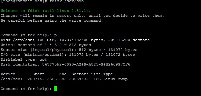

Sorry. In fdisk, use option t to change the type of partition 1. Select partition 1, and then use type 19 for Linux swap.
CookiesMonster
Mar 15, 2021
19
I think that fixed the partition type (see photo).
Now I restart the VM and use free -m or swapon -s to see if swap is active?

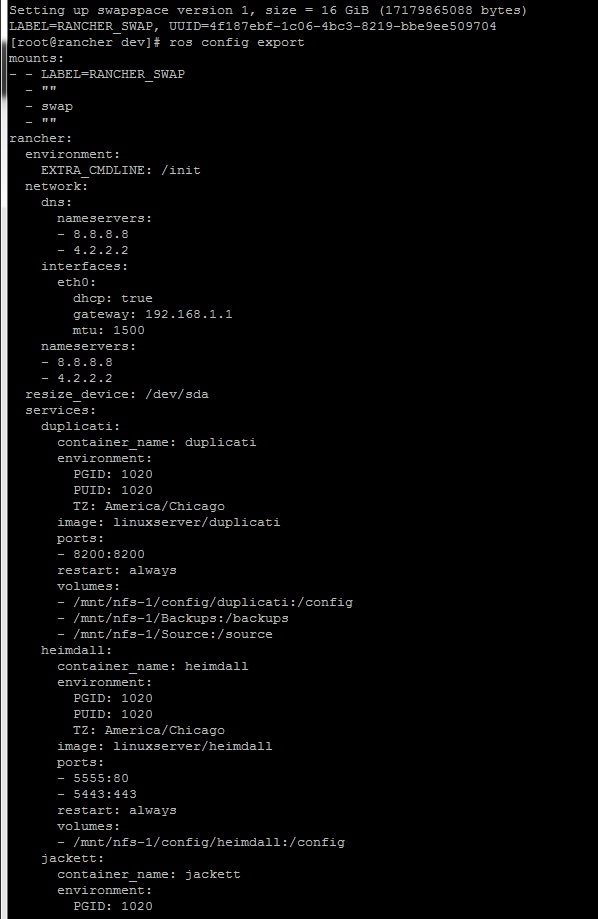

First, mkswap again to make sure. Then ros config export to make sure the mount is in place. Then you can restart the VM.
CookiesMonster
Mar 15, 2021
19
Here's what I get from ros config export .
Does this look OK?

Samuel Tai
Apr 24, 2020
5,399
Yes, that looks good.
