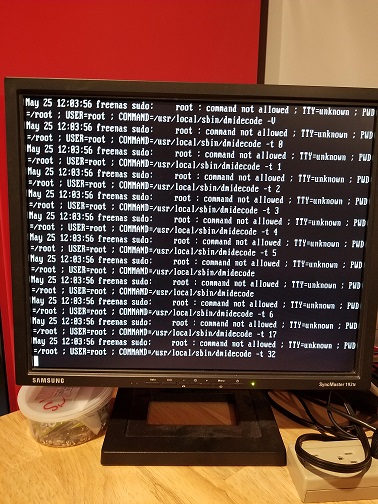

Hello,
Every couple hours, I get this flush of errors on my console. Please see attached picture.
Can someone please explain what's happening.
Other than this, everything else seems normal.
Thanks,
Mike

Check your jails and plugins. There may be a cron job invoking dmidecode. However, this doesn't work in a jail, as /dev/mem isn't available in a jail.

Hmm. Have you looked at /var/log/console.log, and its rolled-over siblings /var/log/console.log.*.bz2 (for these, you'll need to run bzcat /var/log/console.*.bz2 | more to view their contents).
I'm starting to get concerned you may have a malicious process running. Dmidecode is used to scan hardware. Do you share out any datasets to the Internet, say via BitTorrent?

Sorry for the delay. This looks to be the output of debug.log. Do you have any debug alerts enabled? Also, are you running a debug kernel, or have configured "Show console messages" in System->Advanced?

Stupid, stupid me... Months ago I was playing around with a program called "Lansweeper" and forgot that it was still running in the background on another computer on my network. It was set up to automatically SSH into my old server that was running a very old version of freenas (9.2) and collect its configuration using DMIDECODE. It was working just fine. I recently replaced the old server with new hardware and a much newer version of freenas (11.3-U2.1), and the passwords were not configured the same way as the old one server causing DMIDECODE to error.
Many thanks to Samuel. Your suggestion to look at the console.log led me to the solution. I saw that one of the computers on my network (the one running Lansweeper that I forgot about) was connecting to the server using SSH, which then immediately showed the DMIDECODE errors. Shut down Lansweeper and voila, no more errors.
