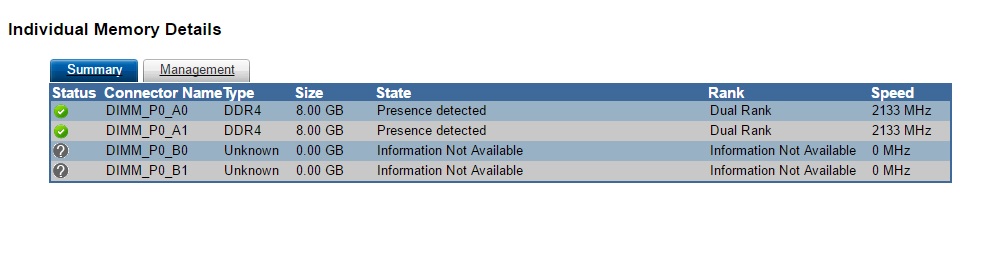

I actually noticed I made a rookie mistake and did not have RAM in the correct slots so I moved 1 stick to the other slot so I'm using "a" channel instead of a1 and b1 I'm now using a1 and a2.

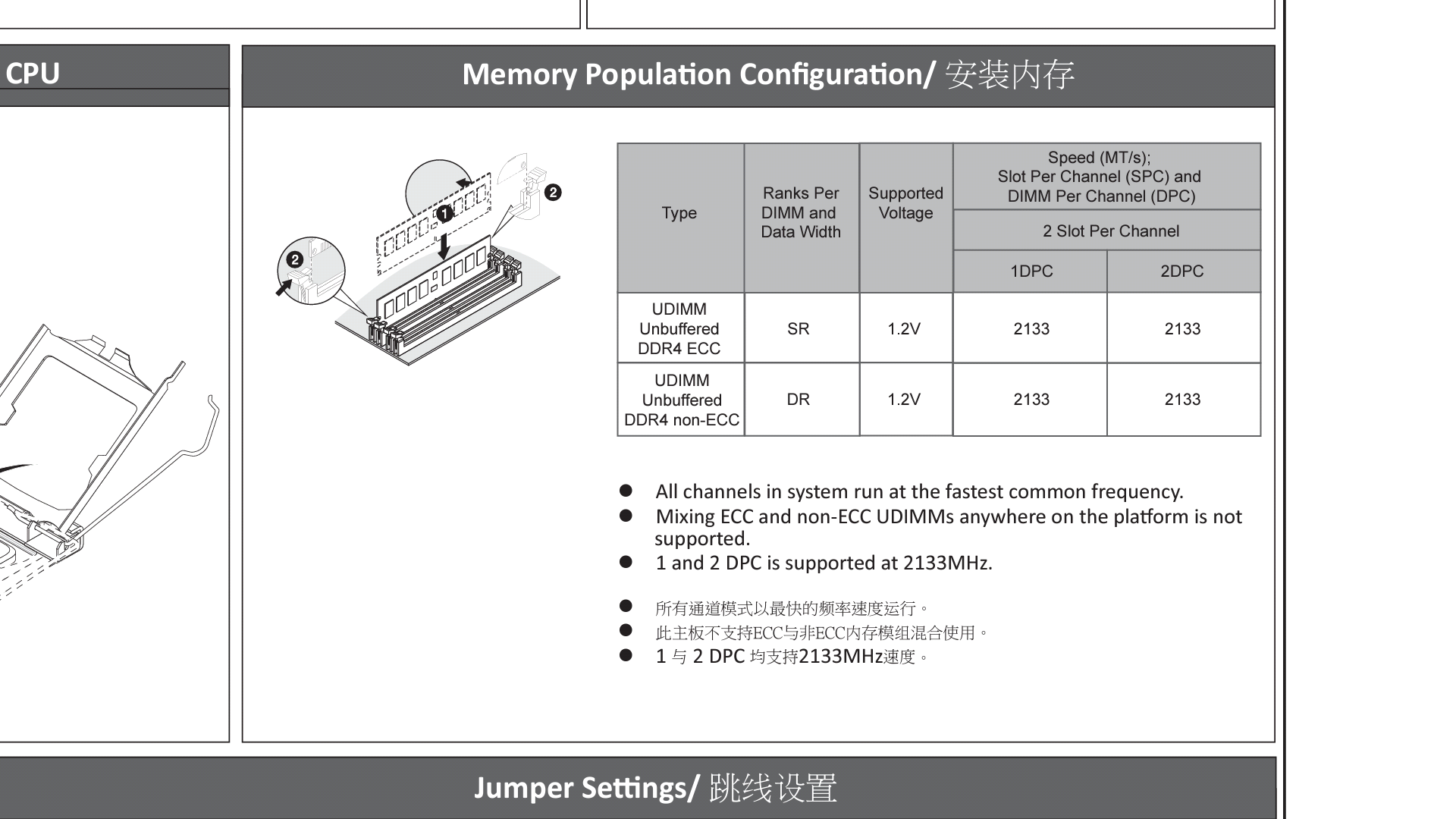

This is the only info I can find about memory config. Screenshot_2016-08-15-09-14-35.png

According to this : http://media.kingston.com/pcn/PCN_KVR21E15D8_8I_C1.pdf
Your modules might be Duel Ranked.
According to that chart you posted ECC modules need to be Single Ranked.
I guess that could explain the issue you have.
I would expect a memtest pass to turn up errors...

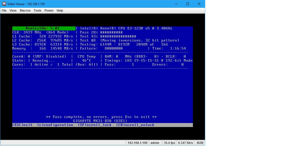

In the current configuration mem.jpg memtest is fine.
I can swap them out again and run another memtest but i have done that before in the other config and the test ran through without errors.....i think.
