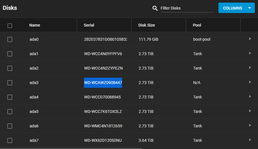

I have copied said drives serialnumber to make the physical disk easier to identify.

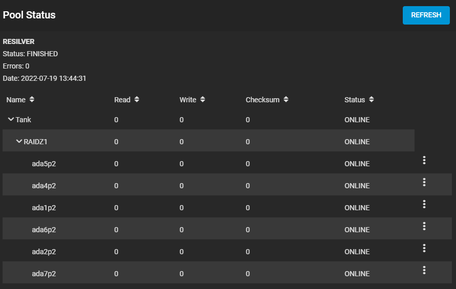

Welp, Ive done all that I summarized, but after pulling the broken disk out, the NAS complains:
CRITICAL​
Pool Tank state is DEGRADED: One or more devices could not be opened. Sufficient replicas exist for the pool to continue functioning in a degraded state.
The following devices are not healthy:
  • Disk 9911428738427028150 is UNAVAIL
2022-07-19 09:23:32 (Europe/Amsterdam)
So apparently I did miss something..
Anyone know what I should be doing?

zpool status is the first thing we need to start ...
Sokonomi
Jul 15, 2018
115
Ofcourse, here you go:
  pool: Tank
 state: DEGRADED
status: One or more devices could not be opened.  Sufficient replicas exist for
action: Attach the missing device and online it using 'zpool online'.
   see: https://openzfs.github.io/openzfs-docs/msg/ZFS-8000-2Q
  scan: resilvered 25.8M in 00:00:06 with 0 errors on Tue Jul 19 10:09:50 2022
config:
        Tank                                            DEGRADED     0     0     0
          raidz1-0                                      DEGRADED     0     0     0
            gptid/73ea972a-d762-11eb-97f5-d05099c19171  ONLINE       0     0     0
            gptid/74b038f8-d762-11eb-97f5-d05099c19171  ONLINE       0     0     0
            gptid/74baea02-d762-11eb-97f5-d05099c19171  ONLINE       0     0     0
            9911428738427028150                         UNAVAIL      0     0     0  was /dev/gptid/74a6b398-d762-11eb-97f5-d05099c19171
            gptid/74cf2566-d762-11eb-97f5-d05099c19171  ONLINE       0     0     0
            gptid/93915049-05ad-11ed-9080-d05099c19171  ONLINE       0     0     0
errors: No known data errors
  pool: boot-pool
 state: ONLINE
  scan: scrub repaired 0B in 00:00:10 with 0 errors on Sun Jul 17 03:45:10 2022
config:
          ada0p2    ONLINE       0     0     0
Patrick M. Hausen
Nov 25, 2013
7,776
So there's one disk missing, which must be the one you pulled out. Did you replace that with the new disk before you pulled it? If not you need to do that now. Can be done in the UI ...
Your new disk is connected? camcontrol devlist shows all the disks the system know about. Also the UI shows the pool status in a way where we can see which GPTID is which disk ...
joeschmuck
Old Man
May 28, 2011
10,994
Yea, I see five drives of the six you originally had. I don't think you have actually added the new drive so you missed some instructions. I'd probably power down and reconnect the drive you pulled out, power back on and scrub the pool again, get it back to normal, then you can start all over. My assessment of your drives is you have one that might have a SATA data cable issue (UDMA_CRC_Errors), but the fact that you cannot always pass a selftest (which is a completely internal drive test) is evidence the drive is premature of a total failure.
Be very descriptive in what you did to get to this point, do not assume we know what you have done, we are not there and you could be making a simple mistake. Treat us as if we are clueless on what you are doing, because we are. This is not to say that we think less of you, it's the fact that a lot is lost by making assumptions. We all want to help you fix your problem with the least amount of trouble and no data loss.

03. I clicked 'Storage > Pools > [cog] > Status' to determine which ada# had the checksum 1.
04. I clicked ' > Replace' on said disk and selected the new disk as the member disk.
05. Waited for it to prattle through the long resilvering process.
06. At this point the pool said it was healthy again.
07. I checked which ada# the broken disk had once more, then clicked 'Storage > Disks' to find the corresponding S/N.
08. Powered down, pulled the disk that matched it, moved the new disk from the spare SATA to the old disks SATA.
09. Powered up, only to find that the pool is degraded once again.
10. Added the old disk back in using the spare SATA, this restored the pool back to healthy again.
So long story short; Can't remove broken disk despite having replaced it with new one.

The pool status also shows all but ada3 present, which is to be expected as ada3 is the 'bad' one that got replaced with the new disk currently residing on ada7.
To verify further, heres the list of disks in the UI;
The highlighted one, on ada3, is the broken drive, its pool is marked as N/A as well, which I assume means its no longer part of the pool and can be safely removed from the system. But when I do, it complains, for some bizarre reason..
joeschmuck
Old Man
May 28, 2011
10,994
Go to the drive listed as ada3 and 'offline' the drive. Once done the pool should still be healthy. Then power down and disconnect the drive, lastly power on again. That "should" work.
Sokonomi
Jul 15, 2018
115
Strangely enough.. it did! Thank you!
