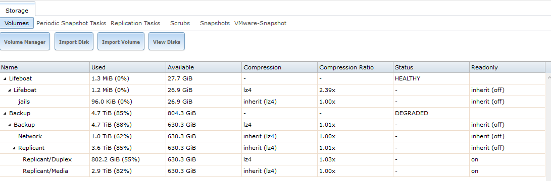

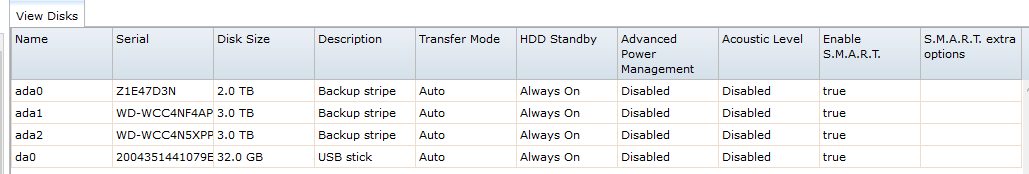

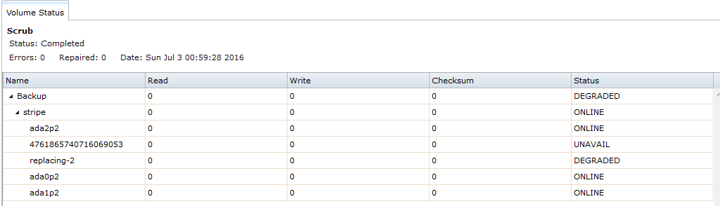

I have just replaced one of the hard disks in a 3 disk stripe, using the FreeNAS GUI, and my system has been left in a confused state. Storage → Volume status shows the new disk, but also the old disk, labelled as UNAVAIL and a disk called 'replacing-2', labelled as DEGRADED. Storage → View Disks shows only the correct 3 disks.
I recently had a warning that one of my volumes was low on free space. The stripe, consisting of 3TB, 2TB and 1TB disks. I already had a 3TB as a spare, so removed it using the GUI and used it to replace the 1TB, again using the GUI. The system seems to be stuck mid-replacement. zpool status -v is included below.
I physically disconnected the old drive and the volume still functions OK. All the files are accessible, so the new disk seems to be in place, comprising 8TB of storage, but FreeNAS reports the old configuration and still claims that I'm low on disk space.
I did a scrub on the volume, but it made no difference.

First of all, the pool is functioning as before. I can read it, I can write to it and I can open files on it. My other FreeNAS server backs up onto it, using replication, and reports no errors. Its snapshots are all there.
I know that stripes have no redendancy. The disk I replaced had no errors, I was just running out of space so attempted to replace the smallest disk in the volume with a bigger one, usin the replace command from the GUI.

What I see is three drives attached and ONLINE (ada0p2, ada1p2, and ada2p2). I also see some weirdness that looks like you need to detach in the GUI your old drive "UNAVAIL" and that "replacing-2" likely needs to be detached as well.
It appears that you are running in a stripe so you are in a pickle. If you detach the wrong drive, your data may go away.

Since you must destroy the pool, or it seems like you must based on previous advice, I still recommend that you go into the Volume Status GUI and "offline" the two drives listed as "UNAVAIL" and "replacing-2". Start with the "UNAVAIL" first and see what happens. Reboot. Does that fix it? If not then do the same for the second drive.

It's showing degraded because of the device unavailability. Detach the "UNAVAIL" drive. If you were actually replacing the drive, this is a necessary step, and your array will return to normal if the drive was successfully replaced.

I offlined the disk labelled "47618......" and rebooted. It just shows OFFLINE. BTW, I had to do this from the command line - the GUI only offered me the Replace option.
The disk labelled "replacing-2"is odd. The GUI offers a Replace button, but zpool, from the command line, says it doesn't exist, even though "zpool status Backup" shows that it does. The physical drive is not connected either.
Whichever way, its a mess. I'm going to detach the whole volume and start again. It'll probably be quicker, in the end.

Since you offlined a disk via the CLI, the GUI wasn't able to track the change. If you export the pool and reimport it, the GUI should be back in sync.

Stux
Jun 2, 2016
4,419
Under the hood, I believe, the zfs replace functionality works by mirroring the drive you're replacing, and the detaching the original drive from the mirror.
But when you attempt to detach the 2nd last drive in a mirror, you get an error (thus being forced to use split to get back to s stripe)
Does replacing a stripe disk even work normally?
If detach doesn't work, then replacing the unavail disk with another disk, and then splitting the resulting mirror should work.
