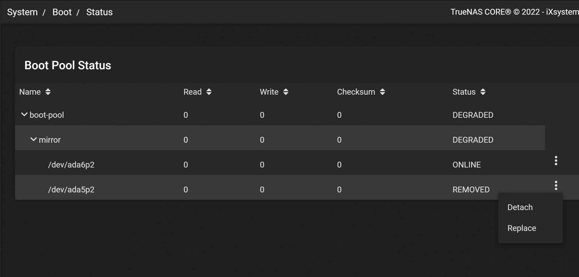

One of my SSD drives in my boot-pool has died. I have physically replaced it on the hardware, but when I try to replace it via the web interface under:
System -> Boot -> Status -> disk
the interface hangs:
Mar 5, 2022
224
I may have caused myself more headache: Since Replace was freezing, I clicked on Detach, and without any warning, the disk was removed from my mirrored pool!
How can I put the replacement disk into the mirrored pool?
Mar 5, 2022
224
I was able to attach the replacement disk to the mirrored pool (very easy, but it was confusing when the screen froze and then I wasn't given the option to do anything after a I clicked the Detach button!)

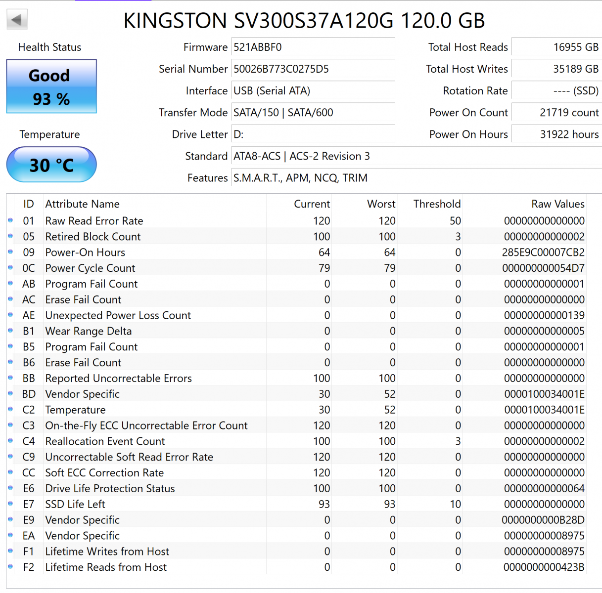

On another note, here is what crystal reports about the "failed" drive:
What am I missing that TrueNAS found?
NugentS
Apr 16, 2020
2,947
doesn't seem anything wrong with it
Mar 5, 2022
224
Right... But TrueNAS flagged it as failed and removed it from the pool... I'll try putting it back in a few days, assuming this one doesn't give me any issues
