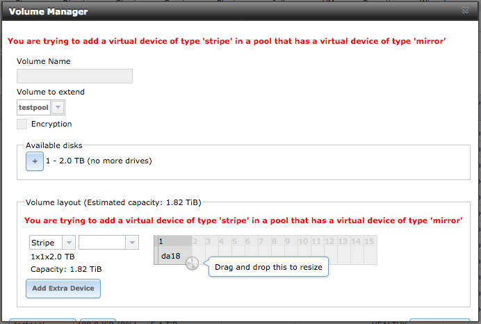

I think I made a mistake. I removed my old drive. Added the new drive and when I went to Volume Manager, the option to Mirror wasn't there. I went to Manual setup and added it to the Volume there. My Volume is still in a DEGRADED state. I looked at my ZPOOL Status and it looked like this:
 pool: VolumeZ
 state: DEGRADED
status: One or more devices could not be opened.  Sufficient replicas exist for
	the pool to continue functioning in a degraded state.
action: Attach the missing device and online it using 'zpool online'.
  see: http://illumos.org/msg/ZFS-8000-2Q
  scan: scrub repaired 0 in 11h17m with 0 errors on Tue Sep  5 14:17:49 2017
config:
	NAME											STATE	 READ WRITE CKSUM
	VolumeZ										 DEGRADED	 0	 0	 0
	  mirror-0									  ONLINE	   0	 0	 0
		gptid/b3014a26-d506-11e4-a3f7-10c37b8fc624  ONLINE	   0	 0	 0
		gptid/0dfa0c01-3623-11e4-98b6-10c37b8fc624  ONLINE	   0	 0	 0
	  mirror-1									  DEGRADED	 0	 0	 0
		8766186258271018871						 UNAVAIL	  0	 0	 0  was /dev/gptid/d9ed7075-4157-11e4-a44a-10c37b8fc624
		gptid/7217ec61-4128-11e4-a44a-10c37b8fc624  ONLINE	   0	 0	 0
	  mirror-2									  ONLINE	   0	 0	 0
		gptid/c63f52d5-53e9-11e7-9c4e-10c37b8fc624  ONLINE	   0	 0	 0
		gptid/c75453b4-53e9-11e7-9c4e-10c37b8fc624  ONLINE	   0	 0	 0
	  gptid/3e7d3fa4-98f3-11e7-9c33-10c37b8fc624	ONLINE	   0	 0	 0
errors: No known data errors
Will my non redundant data become redundant without the mirror? If not, how can I get a copy on the new drive? Should I have added the drive differently? Can I redo adding my drive if I messed it up?
Stux
Jun 2, 2016
4,419
Yes. You made a big mistake :(
You can not remove a vdev from a pool and you've added a new single drive vdev.
You can 'fix' this by adding two new drives. One to replace the failed drive and one to mirror the new stripe.
OR
you can backup your entire pool, re-create it, and restore.
Sep 3, 2017
6
I don't have any more ports to add another drive, let alone two. What happens if I disconnect the new drive? Can I detach it from the Volume? I thought I needed help before, now I need it even more.
Stux
Jun 2, 2016
4,419
You may want to consider adding extra ports, ie by adding an HBA.
You will lose your entire pool (until you reconnect the drive)
No.
Yes.
For future reference, http://doc.freenas.org/11/storage.html#replacing-a-failed-drive
See Fig 8.2.20 Replacing a Failed Disk
You should've selected the offlined disk, and clicked replace.
Instead you used the Volume Manager to override the safetys and added a new disk to your pool as a single disk vdev, ie a stripe.
That has resulted in a new single point of failure. If that new drive fails you lose your pool (this includes removing it), and also the existing mirror with only one member also is a single point of failure.
You can remove the offlined drive from the degraded mirror ( zpool detach), but that will just result in two single disk vdevs (ie stripes) being in your pool.
But you can not remove a vdev from a pool.
The only way to restore redundancy to your pool is to replace the offlined disk in your degraded mirror, to restore it, and then to add another disk to your stripe vdev ( zpool attach) to convert the single disk vdev to a mirror.
Since you have no additional ports... and you probably don't want to acquire another 2 drives... your only other option... assuming you want to restore redudancy, and keep your data, is to recreate the pool and restore from backup. And if you don't have a backup, then you will need to make one.
Unfortunately, the mistake you made is one of the worst :(
There is work being done to make it so you can remove a vdev, specifically to help in this type of situation, but that is for a future version of ZFS, not todays.

There are lots of ways to backup to zfs or other filesystem. Since you can't add more disks to your system you are stuck with network backup or possibly USB drive plugged into freenas. Make sure it's USB 3 and use zfs send/recv
15,504
To quote myself, what part of this screen:
made you think, "sure, I should switch to Manual Setup so I can bypass this"?
I'm serious here. OK, I'm partially being snarky, since any effort to do your homework would have told you you were doing it wrong, but I'm honestly mystified how people continue to blow through this warning screen, which is intended to prevent exactly what you did, to end up with the result you now have.
And how is "Add Extra Device" ever interpreted as the "ooh, this will replace my existing drive" button?
