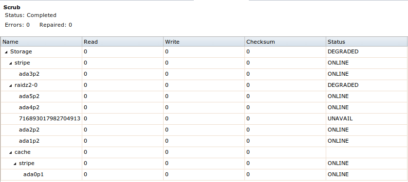

Hey guys,
I messed up when replacing one of my disks that died on my raidz2 array. The single disk now shows up as a stripe instead of replacing the dead drive in my array .
I can't seem to find any way to remove this disk as a 'stripe' so that I can assign it properly. Any help here? I've attached my volume status currently which shows t he degraded array / downed disk and ada3p2 is in it's own group.

Backup your important data and recreate your pool. I don't believe you can remove the strip any other way.
What joeschmuck said. Back it up, destroy and recreate.
Good thing you realized the mistake now, this could've been dangerous later (still is, but less so).
Oh yes, very lucky indeed, even if it's a pain in the rear to do, it's better than loosing all your data.
So while I'm responding here, thought I'd ask why you have a Log (cache) drive for this system. Do you feel you are getting any benefit from it? This is one of those things you can remove if your pool is at the right location. Also, since you will have to recreate your pool to fix the mistake, it's a great opportunity to easily remove the cache.

Having hung out in #ZFS, and paid attention on FreeNAS now for a year, I can tell you, less than 1 person in 20 using an L2ARC is experiencing any benefit whatsoever from it, and most of them are harming performance. It's one of these things that no matter what anyone says, they just don't think you know what you're talking about when you tell them it's not useful in their usecase to use an L2ARC.

And yes, OP, once you stripe in a vdev, it's game over. The pool cannot unstripe any vdev. You have no options other than recreating the pool from scratch.
ZFS is very unforgiving for mistakes. Remove the cache, like joe says, while you're at it.

thanks for the replies. There's no way I can back up my data unfortunately since I don't have enough storage for it. This sort of thing is kind of a major deal and should be very clearly marked with warnings in freenas to prevent it imo. I understand it's user error, but it's not like anything I clicked / read seemed at all obvious that I wasn't replacing a drive and instead creating a 'stripe'. I don't even remember seeing the world stripe used anywhere.
So I guess I'm screwed and going to be forced to return this drive, get a new one and run my array in a permanent degraded state with a drive disconnected.
The cache drive is there only because I had an SSD I wasn't using and wanted to see if it made any difference (it didn't).
Thinking this is going to be the end of my freenas experiment, back to lvm / mdadm!

Do *NOT* run this pool, at all, much less than in a degraded state. You now have an Achilles' Heel---if your striped in drive fails, THE WHOLE POOL GOES DOWN. Plus you're at risk due to the degraded initial vdev as it is. Again, in a zpool, if you lose ANY vdev, you LOSE THE POOL. You have a vdev consisting of ONE DRIVE. If that one drive goes down, you lose the whole pool. Your other vdev is degraded---if that goes down, you lose the pool. Your NAS is now a timebomb that puts your data at more risk than any other solution---for example, the situation is now worse than just an external USB drive plugged in with no redundancy.

You could add another drive to mirror the single drive. You'd have to do that through the command line - look on the forum for instructions.
If that single drive fails, you'll loose everything.

Also, gpsguy's idea is a good one, OP. If you put a mirror on top of the single drive (one of the rare times you're allowed to change an already-deployed vdev), you will improve your situation. I would describe the result as "code yellowish-red" rather than "code uber saturated pigeon's blood red", in terms of danger.
