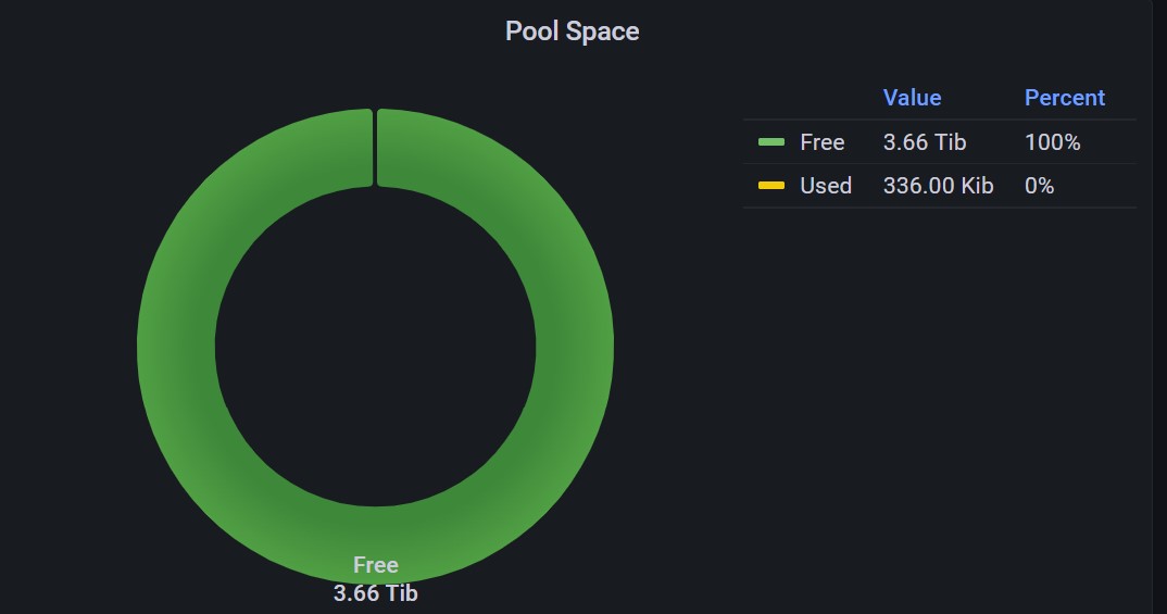

All,
Using Influxdb, Graphite and grafana, I made my own dashboard the other day (just for fun) where TrueNAS reporting populates the data.
Everything works really nicely except for the fact that, for the storage pool, where FREE is reported fine, USED is not correct and REFER is used instead. See below.
Anyone any idea what the cause could be? I just upgraded to 12.0-U7 so am fully up to date.
Thanks!
H
root@freenas:~ # zfs list
NAME USED AVAIL REFER MOUNTPOINT
Main 5.13T 3.66T 336K /mnt/Main
