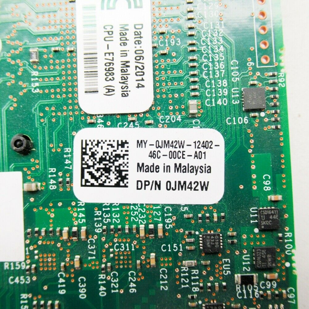

rshakin
Apr 2, 2019
24
it looks like a dell part oem number but it was a system pull so would be weird that it would be counterfeit

jgreco
Resident Grinch
May 29, 2011
18,680
If it was a system pull from a system where it was part of the original hardware manifest, then it's clearly legit. If it is an "aftermarket" add-on, that's where things get dicey, because businesses sometimes try to source "cheaper than Dell retail" Dell cards. The fact that it's a Dell card pulled from a Dell system does not make it clear which of these cases it is.
rshakin
Apr 2, 2019
24
yeah looks like the card is just damaged or something... just tried it in another server and same results yellow light on on of the channels, the other one works. So it's going back to the seller, the other two work fine in my proxmox server nodes
jgreco
Resident Grinch
May 29, 2011
18,680
Oh, see, "eBay purchase" would have been handy to know. It adds another dimension of complication, because the companies and people who scrap out old data center or enterprise computing gear are sometimes not too careful, and often have no clue.
Also there's no actual reason to think that it was a "system pull" as there are a number of eBay sellers who are clearly fronts for Asia-sourced boards, which are *always* suspect in my book. They're happy to list their boards as "system pulls" and "fully tested" but they are often telltale if they seem to have an odd skew of parts that suggests that they aren't actually pulling them -- such as if they aren't also selling servers, memory, disks, and other components. The ones that are selling them alongside other random non-computer crap are the most entertaining ones.
