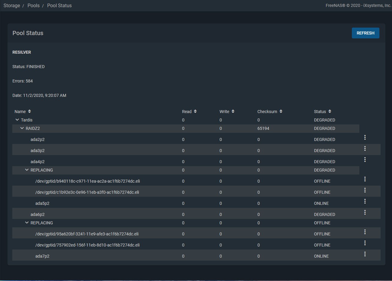

Sorry, I've read through a ton of threads but have not been able to figure this out.
I had 2 drives fail on my encrypted RAIDZ2 Array.
I offline'd the problem disks, shutdown, replaced the drives, and rebuilt. The re-slivering took 4 days but completed. However, I still have "REPLACING" on the new drives with multiple (because I reslivered/replaced them multiple times). Now I have the disk online but 2 /dev/gptid/xxxxxxxxxxxxxxxxx.eli's for each drive.
I don't know what to do.
'zpool status' output:
FreeBSD 11.3-RELEASE-p11 (FreeNAS.amd64) #0 r325575+fb17f3e15b8(HEAD): Tue Jul 2 8 11:09:10 EDT 2020
FreeNAS (c) 2009-2020, The FreeNAS Development Team
All rights reserved.
FreeNAS is released under the modified BSD license.
For more information, documentation, help or support, go here:
http://freenas.org
Welcome to FreeNAS
Warning: settings changed through the CLI are not written to
the configuration database and will be reset on reboot.
root@tardis[~]# zpool status
pool: Tardis
state: DEGRADED
corruption. Applications may be affected.
action: Restore the file in question if possible. Otherwise restore the
entire pool from backup.
see: http://illumos.org/msg/ZFS-8000-8A
scan: resilvered 7.89T in 3 days 13:24:19 with 584 errors on Thu Nov 5 22:44:26 2020
config:
NAME STATE READ WRITE CKSUM
Tardis DEGRADED 0 0 31.8K
raidz2-0 DEGRADED 0 0 63.7K
gptid/8b6a0c20-3241-11e9-afe3-ac1f6b7274dc.eli DEGRADED 0 0 0 too many errors
gptid/8d61beee-3241-11e9-afe3-ac1f6b7274dc.eli DEGRADED 0 0 0 too many errors
gptid/5f6684fa-eebd-11ea-87ca-ac1f6b7274dc.eli DEGRADED 0 0 0 too many errors
replacing-3 DEGRADED 0 0 0
13827796178520726740 OFFLINE 0 0 0 was /dev/gptid/b940118c-c971-11ea-ac2a-ac1f6b7274dc.eli
5347387314038862202 OFFLINE 0 0 0 was /dev/gptid/c1b92e3c-0e96-11eb-a3f0-ac1f6b7274dc.eli
gptid/7c223cfe-1570-11eb-8d10-ac1f6b7274dc.eli ONLINE 0 0 0
gptid/93c04eab-3241-11e9-afe3-ac1f6b7274dc.eli DEGRADED 0 0 0 too many errors
replacing-5 OFFLINE 0 0 0
9147511623165312555 OFFLINE 0 0 0 was /dev/gptid/95a620bf-3241-11e9-afe3-ac1f6b7274dc.eli
7576730276490940677 OFFLINE 0 0 0 was /dev/gptid/757902ed-156f-11eb-8d10-ac1f6b7274dc.eli
gptid/d249ef34-1d1e-11eb-8d10-ac1f6b7274dc.eli ONLINE 0 0 0
errors: 1168 data errors, use '-v' for a list
pool: freenas-boot
state: ONLINE
scan: scrub repaired 0 in 0 days 00:09:38 with 0 errors on Tue Nov 10 03:54:38 2020
config:
freenas-boot ONLINE 0 0 0
mirror-0 ONLINE 0 0 0
da1p2 ONLINE 0 0 0
da0p2 ONLINE 0 0 0
errors: No known data errors
root@tardis[~]#
