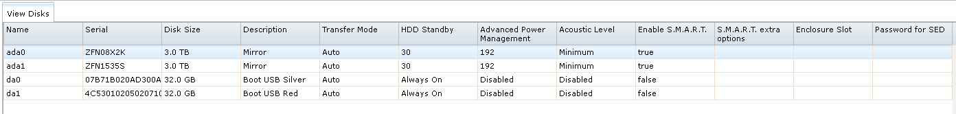

[root@freenas ~]# diskinfo -v ada0
ada0
        512             # sectorsize
        3000615492608   # mediasize in bytes (2.7T)
        5860577134      # mediasize in sectors
        4096            # stripesize
        0               # stripeoffset
        5814064         # Cylinders according to firmware.
        16              # Heads according to firmware.
        63              # Sectors according to firmware.
        ST4000DM004-2CV104      # Disk descr.
        ZFN08X2K        # Disk ident.
        Not_Zoned       # Zone Mode
[root@freenas ~]# diskinfo -v ada1
ada1
        512             # sectorsize
        4096            # stripesize
        0               # stripeoffset
        ZFN1535S        # Disk ident.
[root@freenas ~]#
