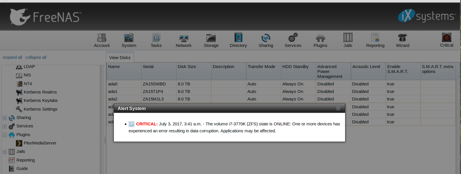

In my FreeNAS box the Critical button suddenly blinks red with a Warning:
I checked a few Forum posts and followed the general advice to use
zpool status -xv
Which indicated only one of my file was corrupted. I therefore deleted it and copied a good replacement from my back up.
The Critical button still brinks red. I issued the above "zpool status -xv" again and a different message came out:

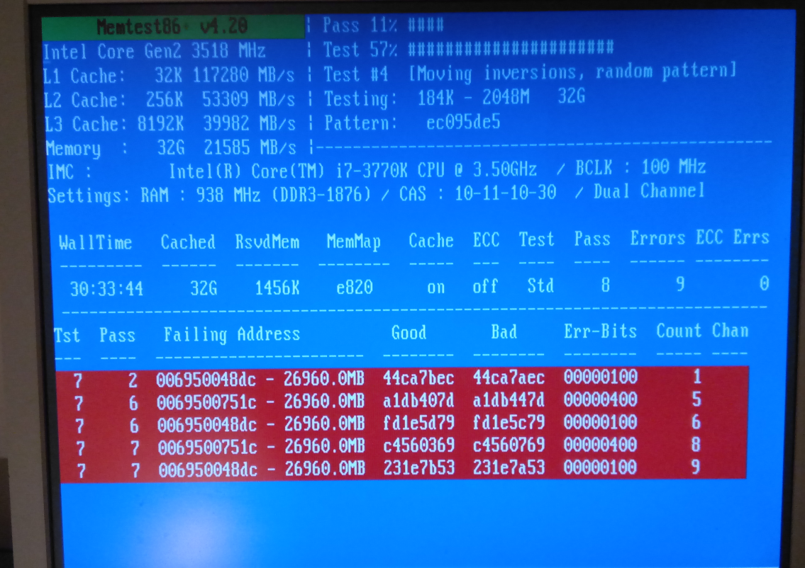

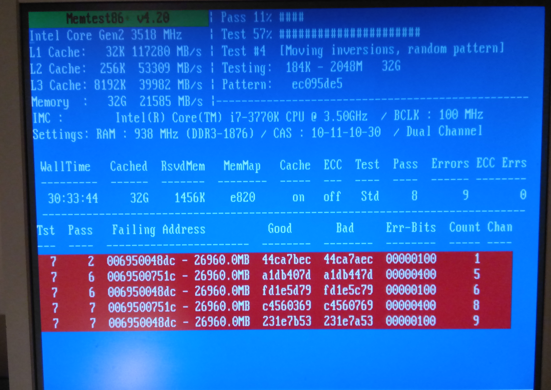

I followed joeschmuck's suggestion to Memtest the memory. After 30 hours and 8 passes 5 errors were reported at two addresses. I need to take the memory out to test one at a time to find which one is faulty or if the slot is bad too.

As for the RAM test failure, the failure may not even be in the RAM itself so my advice is this:
1) Ensure you have compatable RAM for your motherboard.
2) Ensure the RAM speed is set proper and the voltage is proper on the motherboard for the RAM you have.
3) If you have high speed RAM, try to run it at a normal clock speed and retest.
4) Try one stick at a time and retest.
If you cannot isolate the failure to a single stick of RAM then look at the power supply, motherboard, and CPU, in that order, well that is the order I'd do it.

One of the best way to learn is from one's own mistakes. My long term plan is to build a FreeNAS with recommended hardware. I still like to bottom out the shortcomings of my existing PC harware so as to avoid them in my next move.

I never over-clock and the ram is always bought at the highest recommended normal speed (no OC) by the motherboard vendor. This is the first time I got an error in the ram but I have never had a need to check it out in the past.
The ram in trouble is powered by Corsair TM850M PSU and the box itself is connected to a 1200Watt UPS. I would have gone for ECC ram if it is widely available and not restricted by the motherboard. Mind you the PC is a few years old and wasn't originally assembled with FreeNAS in mind.

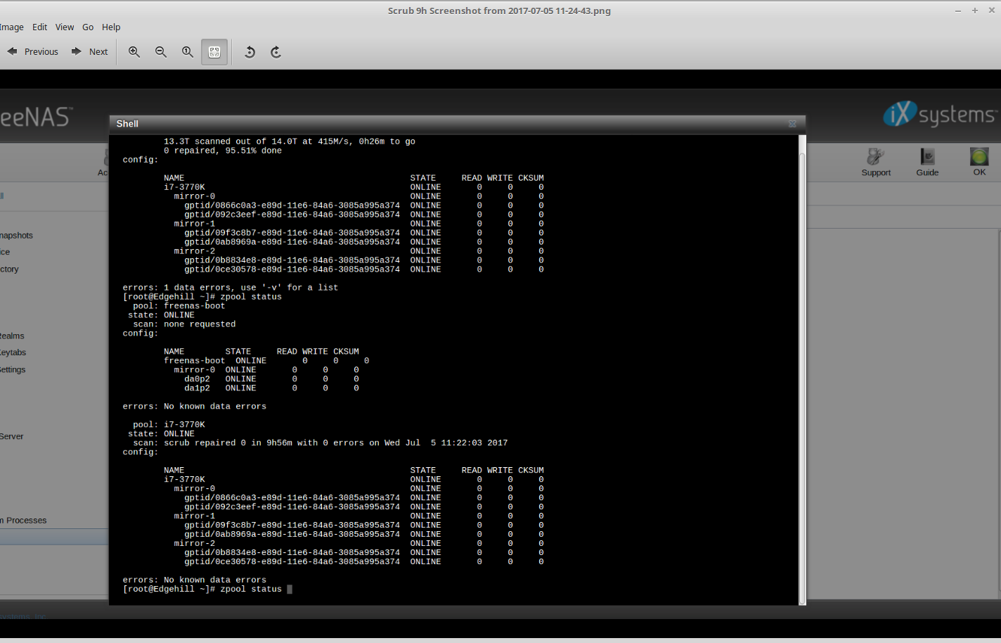

Latest situation
30 hours Memtest result:
9 hour scrub
26minutes earlier before the scrub finished the alert button was blinking red with the error still showing. After scrub finished, with no error reported, the alert button goes green showing "The system has no alerts". Do this mean my zpool is alright now? I did replaced the only erroneous file reported by "zpool status -v" before scrubbing the pool.

My advice is to drop your RAM speed down to DDR3-1600 and retest. Since it appears only Test 7 is failing and only in a specific memory location,you could run only test 7 and that specific memory section if you like to stress that area. I would still suggest running MemTest86 on all your RAM since you changed the RAM speed. If your RAM fails then you will need to isolate which stick is failing and replace it.

Latest situation
9 hour scrub
If the scrub says the pool is good, then it probably is.
Fix your broken hardware and be happy that ZFS worked like a trooper.

But it didn't:
		i7-3770K:<0x13572>
Latest scrub says "no known data errors". The inconsistency is explained by the faulty ram.
Stux
Jun 2, 2016
4,419
That permanent error occurred before I scrubed the pool.
And if it's no longer reporting as an error after the last scrub, the 'permanent' error is gone.
