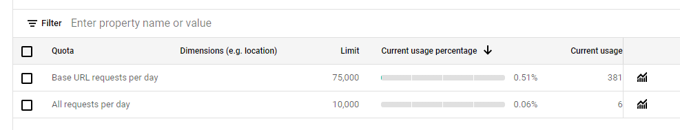

Currently the sync for me fails because of the following error: "Quota exceeded for quota metric 'All requests' and limit 'All requests per day' of service 'photoslibrary.googleapis.com" anyone else experienced this?
brahmy
Mar 24, 2022
13
Yes I have seen this...
Suggestions:
  • Ensure you are NOT syncing the /by-day folder. This apparently causes a ton of API requests and you're limited to 10k per day. You will quickly blow through this limit. (photos will eventually sync if you leave the task running, every 24h whenever Google resets their API counter)
    • Instead, I am syncing the /media/by-year/2023 and I just have a manual calendar reminder to update this task every year.
  • If you're syncing ALL your photos for the first time and you have a lot - it might take a couple days / API requests to sync them.
  • Ensure your API app is in Production, not Testing mode... or else your credentials will expire after a week. This drove me absolutely batty.
Using the by-year folder sync, I just synced a month or two of photos and this what my API limits look like:
In contrast, I have an image on this ticket of hitting 10k API requests per day when trying to sync the by-day folder for my entire Google Photos library history.
Hope this helps
EDIT: Another tip I'd like to share is using healthcheck.io's free cron job monitoring service to troubleshoot this finicky backup system. Easy for this to fail and not provide an alert. Sign up at https://healthchecks.io/, create a check, and add the following post script to the cloud job:

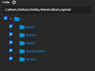

how are you forcing the /mnt/by-year/
I've tried to input it manually in cloud synch task:
/,/media,/media/by-year/
/media/by-year/
But ASA i save it, it gets replaced by mombo jumbo stuff or i get "All selected directories must be at the same level i.e., must have the same parent directory"
The dry run works om /media/by-year/ ( i see pics being skip because they exsist) but on save it gets replaced by /media/by-year//,/media/by-year//media
/media/by-year/

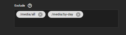

Did you figure this out? I am running out of All request and I am trying to not sync by day. I am getting the same thing you are getting, but I cannot even complete a dry run let alone save it. Thanks
hedchange
Mar 10, 2023
4
/media/by-year/
I have put some folders in the exclude in the section.
I have not gotten change to run it yet as I am out of requests. I did however select all the folders including root for the photos.
I will follow up and see what it does in the morning when it reruns.

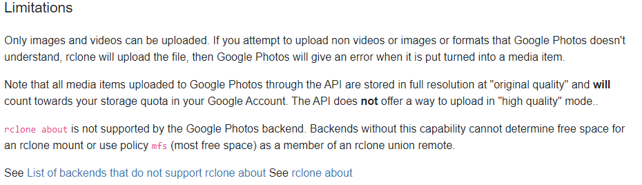

I tried to add to the Exclude section, but it does not work....it keeps synching by-day, by-month and by-year. This is bad cause you basically get 3 copies of the same thing consuming space.
Another bummer I found yesterday is that this method compresses photos and videos, looking at the rclone page, this is expected:
Is there any alternatives to get this with original quality that can be automated at Truenas?
