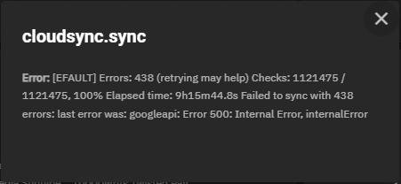

All the docs seem to make it seem like it's a finished feature, but I start a SYNC PUSH task, and it fails with error 500 on almost 500 files (I can't find any logs to find out more). I've tried the task 3 times and it just fails the same every time. I've re-authorised the Google credentials and am about to manually create an API key but I thought I'd ask here first. Would manually creating an API key through Google Admin even help?
The task runs; it backs up 16 TB of data but then fails to delete the moved or deleted data and tells me that there are 500 files that didn't backup but not what they are or why.

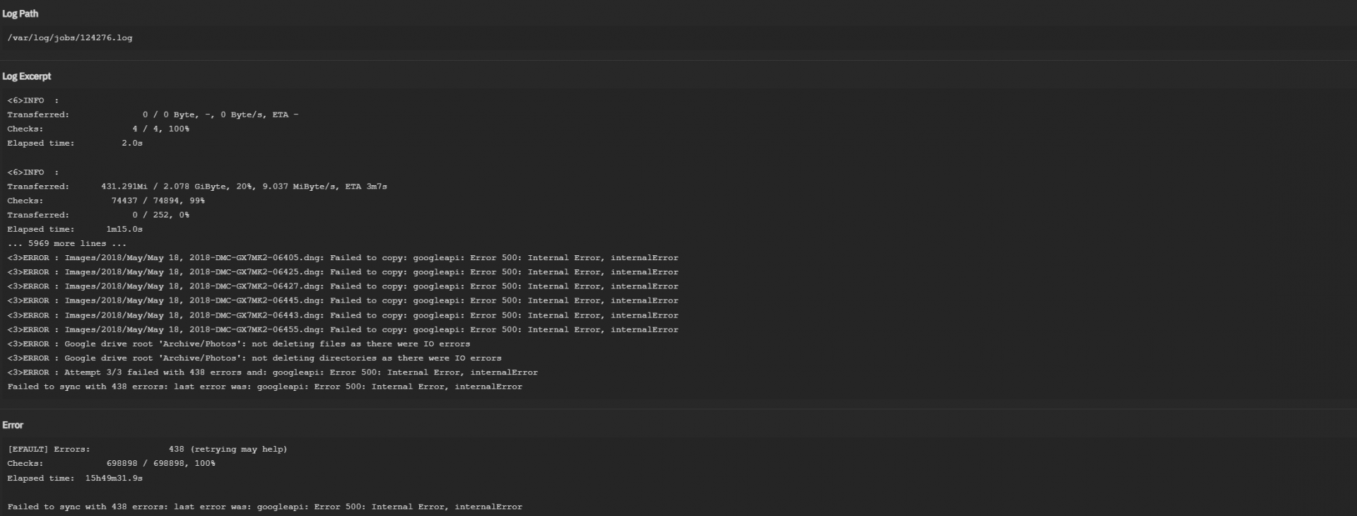

Is there anywhere I can find more detailed logs for the sync task?
