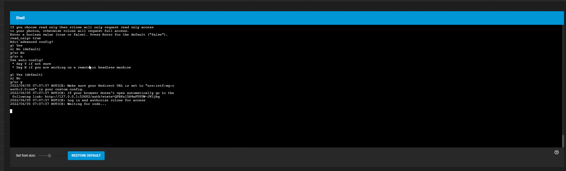

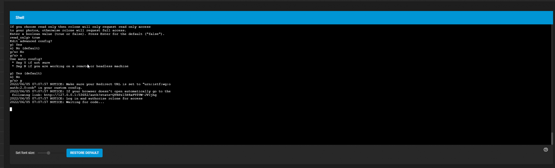

Thanks for the guide - very helpful. I got stuck on step 21.
I tried browsing to the link http://127.0.0.1:53682/auth?state=QTBPzl5H4xFT8TW-JVIjhg but it didn't work. I tried replacing the 127.0.0.1 with the IP of my NAS box but couldn't get it to work.
Hi there, you can also do "n" at that step and it will give you a link to go to in your browser and your browser will give you a code to paste back in.
I might update the instructions to use that method instead of auto configure.
Also, nice idea to use the truenas itself as the rclone box considering it already has it installed! I might update the instructions to use that too.

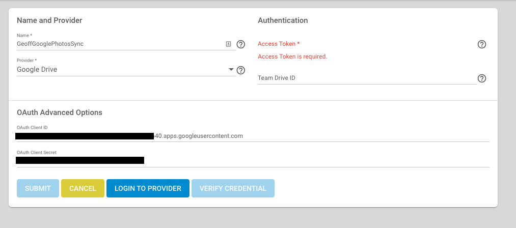

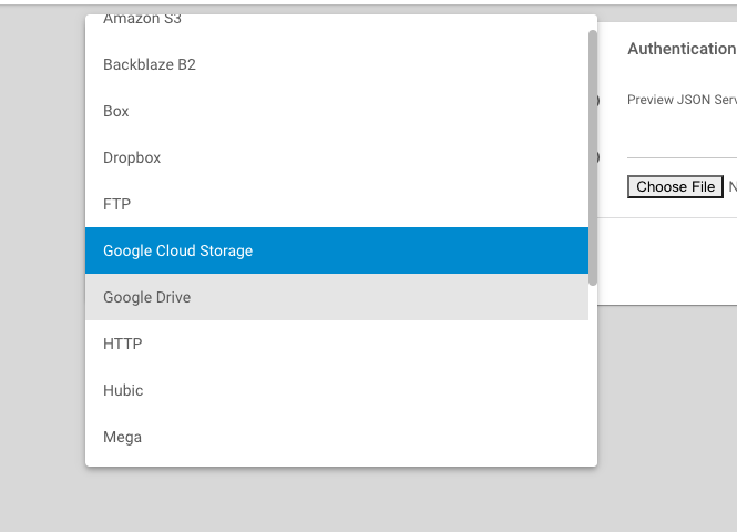

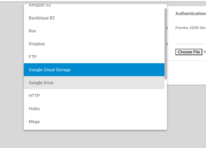

Starting with Step 24, the TrueNas console doesn't really align. For starters in step 24, there is no "Google Photos" option. There is just Google Cloud Storage and Google Drive. Only the G Drive option accepts the ClientID and Secret option however...
Once you put that in, there is no option to simply accept of verify the credentials. You MUST choose the Log In to Provider option as your only next step.
Additionally the Google Drive requires the Access Token option to be set.
Are you using TrueNas Core? If I recall correctly Core does not support Google Photos, only Scale does which is what I based my tutorial off of.
