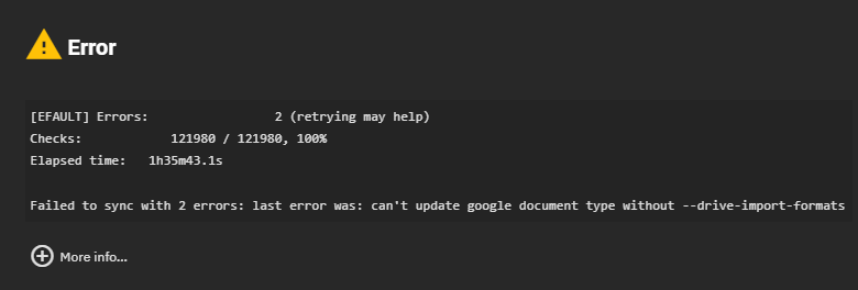

Running 22.02.03 and trying to get a few directories to sync with Google Drive. After the scheduled event, I get the following error:
Failed to sync with 2 errors: last error was: can't update google document type without --drive-import-formats
So, I'm like cool, I just add "--drive-import-formats" as a prescript... looks to me like a rclone flag. But it doesn't like it and fails immediately with:
[EFAULT] Pre-script failed with exit code 127
Am I not doing this right? Is it a post script or exclude? Is it time to ditch Drive and go with Backblaze?
So, the first error isn't too big of a deal because it still runs the backup... sort of. I'm running a push sync and what it doesn't do is remove any deleted files off of Google Drive. The logs say so:
<3>ERROR : Google drive root '': not deleting files as there were IO errors
<3>ERROR : Google drive root '': not deleting directories as there were IO errors
<3>ERROR : Attempt 3/3 failed with 2 errors and: can't update google document type without --drive-import-formats

It happened again after the 22.02.4 upgrade. I read a post somewhere regarding .gdoc files causing issues in rclone, so I searched and destroyed all that I could find in my shares and on Google Drive. But there may be others in the form of other types... TBC.
<6>INFO :
Transferred: 0 / 0 Byte, -, 0 Byte/s, ETA -
Errors: 2 (retrying may help)
Checks: 121980 / 121980, 100%
Elapsed time: 1h35m43.1s
