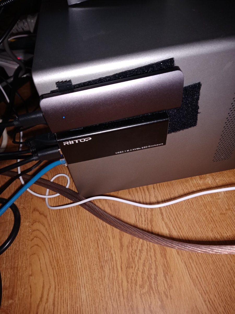

No retention mechanism?
Whats wrong with this then?
:cool:
Retains them perfectly. In fact thats heavy duty Velcro - it retains too bloody well - its a strain to remove if I need to
Doesn't look very elegant I will admit.
