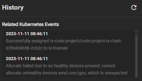

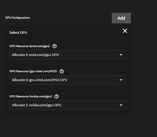

CodeProjectAI isrunning trying to run in a docker container and no matter what is selected in the "GPU Configuration" section of the container it fails to load the pod and throws an error. "Allocation failed ... amd.com/gpu ..."
It throws this error if I select the Nvidia GPU as I've done with the other apps or without doing that.
How do I get this to run and use the P1000? Or in worst case just run without using any gpu's?
