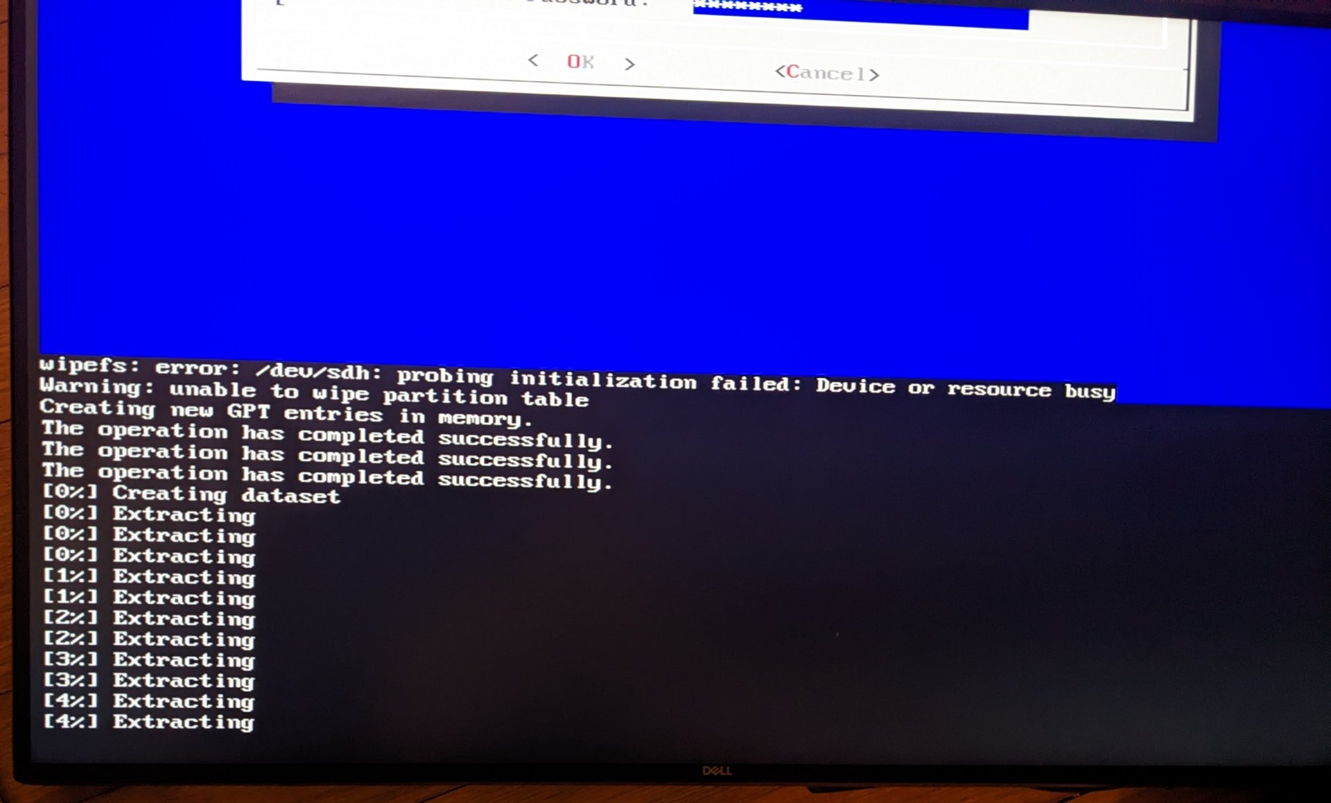

    • After choosing the admin password and proceeding, installation started immediately with:

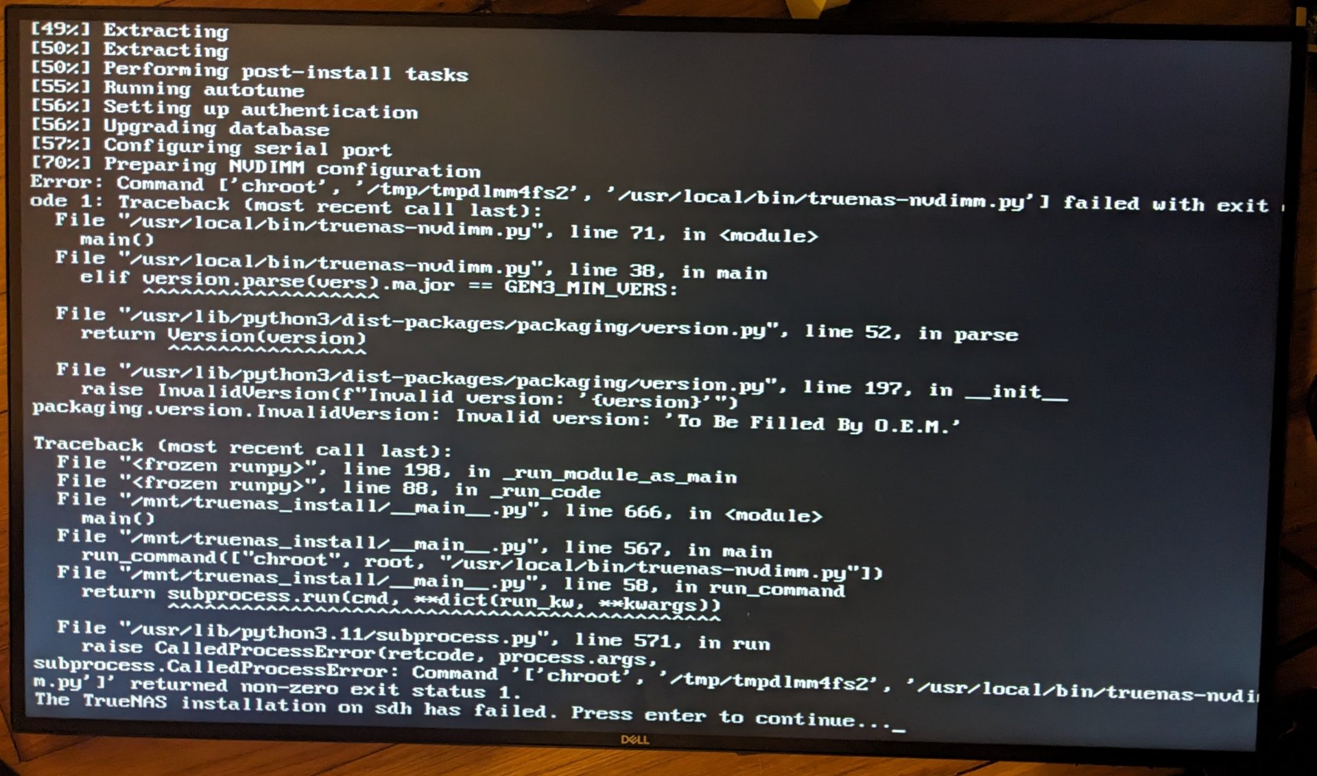

    • After the extraction and performing post-install tasks, the installation failed during the "Preparing NVDIMM configuration" step:
There was very little user involvement as I walked through the installer as instructed. Is there anything I can do on my end to fix this issue. Cheers!

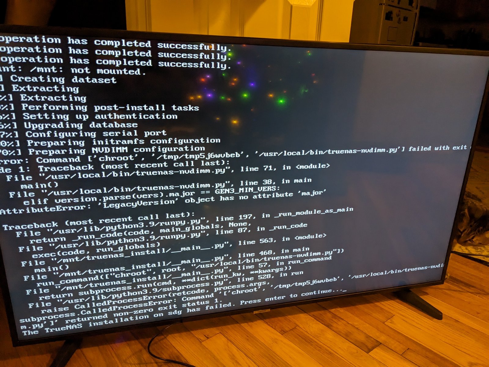

[FAILED] Performing a clean install using an earlier version of TrueNAS-SCALE-22.12.4.2​
  1. Failed at a similar error (screenshot attached + bonus cat). I looked at the truenas-nvdimm.py python script in your middleware repo and based on the python stack trace it appears to be looking for an attribute "major" for the "LegacyVersion" object to compare it to "GEN3_MIN_VERS", but the object doesn't have the attribute so it fails.
  2. You guys don't have issues enabled in the github repo so I could not open an issue but here is a possible fix for the failure. You'd just have to populate how to handle the case when the version doesn't conform to the expected format:
def main():
    prod, vers = parse_dmi()
    gen1_2 = gen3 = False
    if not all((prod, vers)) or not prod.startswith('TRUENAS-M'):
        return
    try:
        parsed_version_major = version.parse(vers).major
    except AttributeError:
        # Handle the case where the version string does not have a 'major' attribute
        parsed_version_major = None
    if parsed_version_major == GEN3_MIN_VERS:
        gen3 = True
    elif parsed_version_major is None:
        # Handle versions that don't conform to the expected format
        # I'm not familiar with the install process to decide how to treat such cases, here I assume they are gen1_2
        gen1_2 = True
    else:
        gen1_2 = True
    # Rest of the code...

Error
[EFAULT] Command ['chroot', '/tmp/tmpa004yqun', '/usr/local/bin/truenas-nvdimm.py'] failed with exit code 1: Traceback (most recent call last): File "/usr/local/bin/truenas-nvdimm.py", line 71, in main() File "/usr/local/bin/truenas-nvdimm.py", line 38, in main elif version.parse(vers).major == GEN3_MIN_VERS: ^^^^^^^^^^^^^^^^^^^ File "/usr/lib/python3/dist-packages/packaging/version.py", line 52, in parse return Version(version) ^^^^^^^^^^^^^^^^ File "/usr/lib/python3/dist-packages/packaging/version.py", line 197, in __init__ raise InvalidVersion(f"Invalid version: '{version}'") packaging.version.InvalidVersion: Invalid version: 'To Be Filled By O.E.M.'

middlewared.service_exception.CallError: [EFAULT] Command ['chroot', '/tmp/tmpa004yqun', '/usr/local/bin/truenas-nvdimm.py'] failed with exit code 1: Traceback (most recent call last):
  File "/usr/local/bin/truenas-nvdimm.py", line 71, in <module>
    main()
