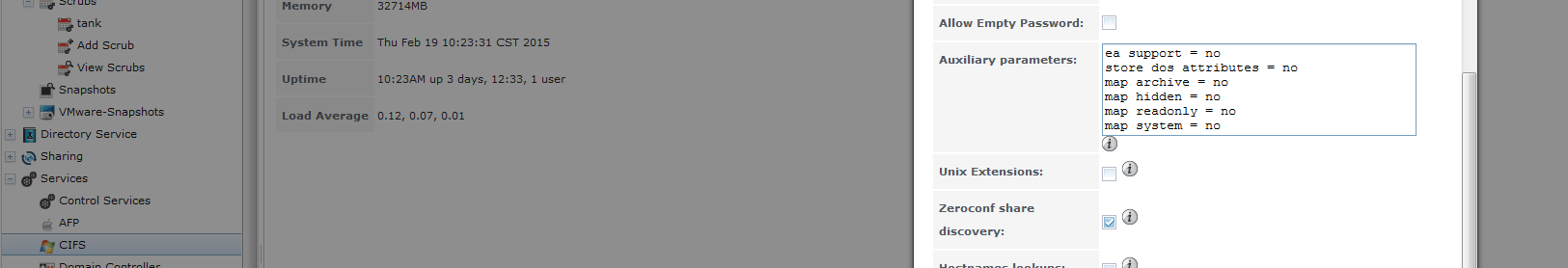

Under the CIFS Settings page you can add the following settings as shown below:
Simply add the following to the Auxiliary Parameters of CIFS settings and save the changes. They will immediately apply themselves.

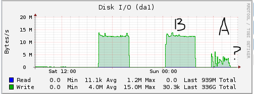

Does one need to reboot the server or just restart CIFS service for the benefit to be seen? I am not seeing an improvement with #4.
Image shows one disk with a file of the same size of file before and after on the right. I canceled the 2nd transfer when it kept dropping in transfer speeds.
I was copying from one FreeNAS to another. The server build is in the header and identical for both units. Win7 box acting as CIFS client.
Any ideas?

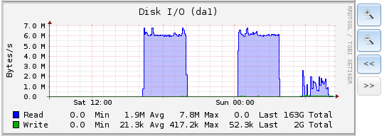

webpilot
Nov 9, 2015
27
Here is the write view on the receiving 9.3.1 stable box. B was before and A is after the Auxiliary Parameters changes were saved.
Both CIFS options were setup with the six Auxiliary Parameters.
This started out as a means to mass copy files and stop an nvalid MS-DOS popp-up. I was getting an Invalid MS-DOS issue reading files from the freenas server to the win7 client from files copied over from an external drive and suspected an extended attributes issues. If it is an EA issue, are all six entries needed in the CIFS parameters to work correctly?
