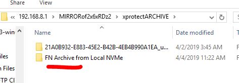

With ixsys (and stream_attr) enabled on this specific share:
smb: \xprotectARCHIVE\> ls
  .                                   D        0  Fri Mar 22 13:30:38 2019
  ..                                  D        0  Mon Apr 15 14:34:22 2019
  21A0B932-E883-45E2-B42B-4EB4B990A1EA_unrepairable_tables      D        0  Sat Apr 20 02:29:27 2019
  21A0B932-E883-45E2-B42B-4EB4B990A1EA      D        0  Sat Apr 20 20:05:52 2019
                26325678353 blocks of size 1024. 14678816120 blocks available

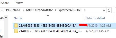

With ixsys NOT enabled on this specific share ( so only stream_attr) :
Try "help" to get a list of possible commands.
smb: \> cd xprotectARCHIVE\
  21A0B932-E883-45E2-B42B-4EB4B990A1EA     DS        0  Sat Apr 20 20:05:52 2019
                26325009455 blocks of size 1024. 14676059495 blocks available
browsing the share from a win 2012 (or tested with a win 2016 vm i also tested with), shows both the same results as above. it looks like its only something windows is picking up on some how?
(fwiw, these folders are used/created by Milestone Xprotect, a windows based NVR / IP cctv camera recording software, its where it archives the video to (from the local storage) after 5 or so days for archiving purposes, the folder name that keeps swtiching back and forth "FN Archive from Local NVMe" is what i labeled the "archive" as in Xprotect).

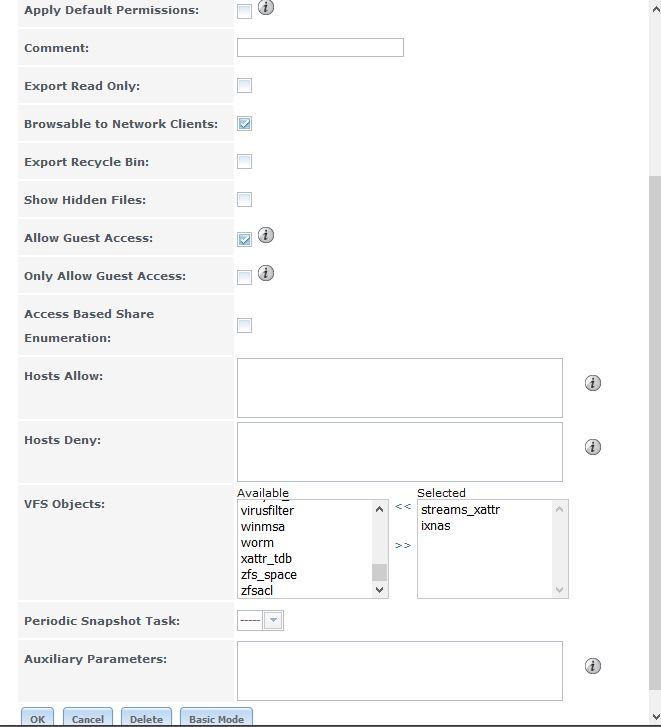

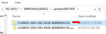

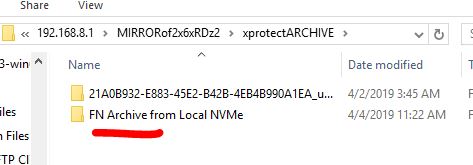

(see my reply above), i tested some more, and in terms of the folder changing names w/wo ixnas, its def specific to ixnas
as i did a new fresh install of xprotect (on a new, different 2016 server vm), and after a reboot it shows this archive dst (smb share) as unavailable, even though it is (but the folder name is not showing correct):
if i remove ixsys , then reboot the vm, it shows as available (and the folder has the correct name i gave it):
