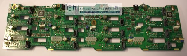

I should probably get an IT Flashed Raid card then, shouldn't I? Any recommendations with either 4 SAS ports (to sata) cards?
I m ow you referenced dd with the drives, but how did you burn them in? Could it just be a dodgy drive?
How are the drives connected to the beastly 12V rail?
As for burning them in, wrote to each one ( # dd if=/dev/zero of=/dev/ada${x} ) for a minimum of 24 hours each. and then read from them to verify that everything was zero (nul) with dd if=/dev/ada${x} | grep -zq . && echo non zero and It'd be 3 dodgy drives then, which seems highly unlikely??
And for how they're connect to the rail, it's got 4 molex to backplane then backplane to drives. (Picture attached, is the back view of it)
Marvel sata ports will have timeout issues as shouldn't be used.
And here I thought I did all my research :(. Alas, live and let learn... But theoretically I shouldn't have any issues with Intel ones, correct?
