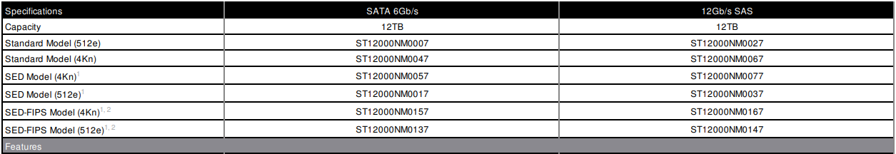

HoneyBadger cares a little bit!!! Thanks. See, the output below:
HoneyBadger cares about data integrity. ;)
Device Model: ST12000NM0007-2A1101
Well, I hate to be the bearer (badgerer?) of bad news but those are not SEDs - that model identifies it as the regular 512e version.
https://www.seagate.com/www-content...cap-3-5-hdd-12tb-v7DS1925-1M-1703US-en_US.pdf
hnmcclain
Apr 19, 2019
3
Literally, came to the same conclusion after some digging over the weekend. Purchase order has them listed as SED but they clearly are not. Thanks so much for helping me confirm and keeping my sanity.
