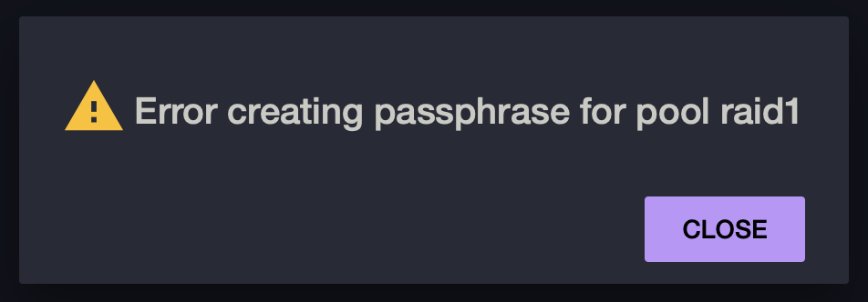

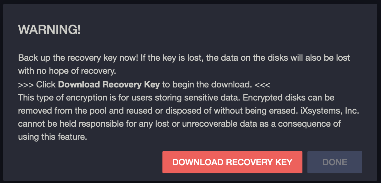

Once it'd finished, and I couldn't find the key, I said screw it, let me try booting from it (now that I was back with the server). Sure enough, it booted up (although, it began the upgrade process to 11.2-U6, which I stopped halfway. It booted up, and I started poking around. I unlocked the pool with just the password, as usual (since I assume it's using the geli key in the /data/geli/ directory. Interestingly though, the /data/geli/[hash].key geli key was at zero bytes. I thought that was odd after I'd scp'd it to my local computer. Well clearly that's useless (but how did it unlock the drives anyway? ). So I logged into the GUI, and started clicking around. I saw a "encryption rekey" and I figured what the heck, might as well try this while I still have access to my encrypted pool!. So I did that, and it wrote over the zero byte geli key, with 64 bytes. That looks better! So I downloaded that (both through the GUI, and through SCP to be sure), and now confident that I was armed with the correct key, I shutdown, swapped the USB thumb drives, and booted into the fresh 11.2-U6 install. I headed over to the storage section, went to unlock my pool, and again, the same error (as above). I also tried (again) to do it from the command line.
So, here I am.

- Rekey pool. Download geli_recovery.key (note: different MD5 from "original" one).
- New install of 11.2-U6 still doesn't accept key and passphrase.
