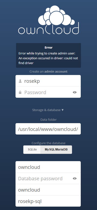

Just want to start out by saying thank you @DrKK for this guide. I agree that using the OC plugin for FreeNAS isn't for most people especially since it assumes WAY too much about the initial setup. Now for my question, I've been going through the OC admin guide as well as your instructions (as well as watching your video on YouTube) to sort out how to do the initial setup with an instance of MariaDB/MySQL. I have a SQL server running from another jail and installed the client on the same jail as OC (had to do a little tweaking to get the OC jail to recognize the resolve name for the SQL database host).
I followed the instructions and have it configured for SSL with security (no longer seeing the warning about the .htaccess file), but still can't seem to prompt for database configuration aside from SQLite. Any ideas?

Thank you for the feedback @DrKK, it is greatly appreciated. However, by muddling around Google, OC Documentation, and running a series of pkg search (as well as trial and error pkg install commands) I was able to figure out why I was not seeing the option to choose another database. But, as you said, getting a connection to an instance of SQL is another beast entirely. If you want to add this to your guide and/or YouTube video, the command I ran was thus:
pkg install phpXX-mysql # XX signifies the version of PHP installed when running pkg install owncloud (e.g. php56-mysql as of 6/14/15)
This allows php and OC to recognize SQL connections from MariaDB/MySQL in addition to SQLite. If I figure out how to get the connection to work, I will keep you posted so you can supplement your guide for those who wish to use databases that can handle larger (100GB+) instances.
Now, for the million dollar question. When you were attempting to connect an external database (regardless of where it was hosted within the jail, another jail, or another system altogether), were you getting resistance due to a "missing" driver? I've attached a screenshot for "clarification" (I'm of course using the word "clarification" loosely since the error is incredibly vague).

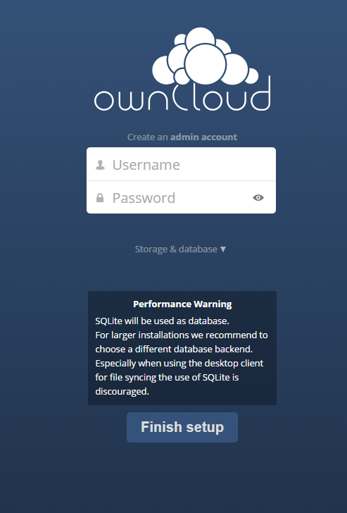

small update i was following your video (its great) and i hit a snag that sqlite was not available i had to manually install php56-sqlite3 for it to work im guessing someone forgot a dependency somewhere?
By the way, I am going to update the original post here with the fact that the FreeBSD port for owncloud no longer is configured by default for sqlite3.
yea i noticed that when i was installing it yesterday manually installing php56-sqlite3 php56-pdo and php56-pdo-sqlite
solved that issue

Also, there's not a thing in the world wrong with the sqlite-based Owncloud, for a user or two, except the the performance is mediocre. e.g., files might sync at 50-100Mbps max. If that's ok with someone, then, in principle, they can go with that.
