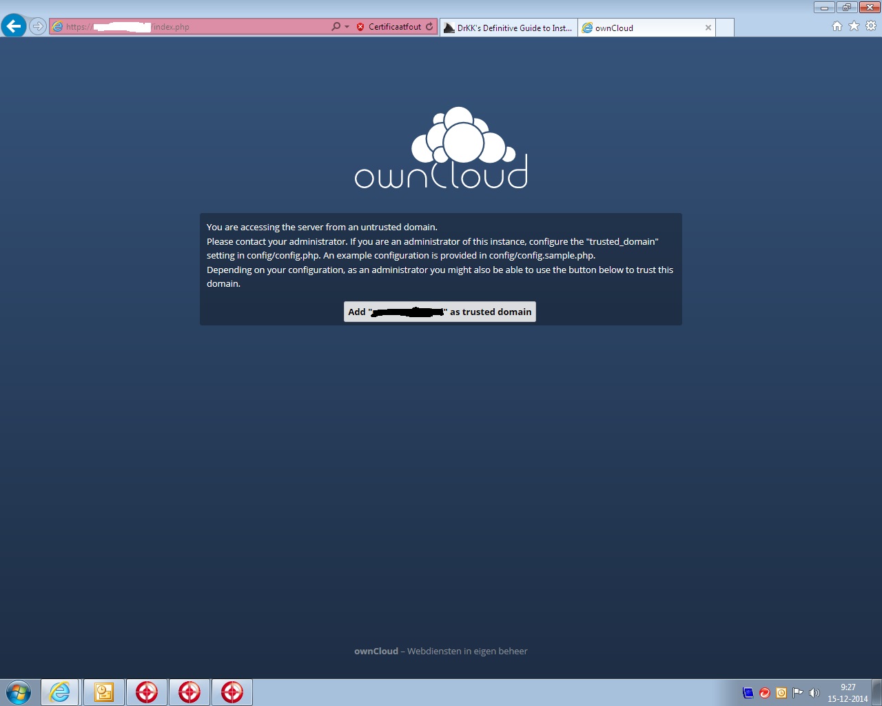

Deleted member 37853
Guest
I have https configured. If I go to my ip address locally I get a warning that my certificate is not good, but I can continue.
Which port do i have to open on my router to connect to my Owncloud from the outside (WAN)? I have https so I thought of port 443. But if I try to connect with my phone for example (with the owncloud app) I got an error.
I have https://<MY WAN IP> and than I use my username and password to try to connect. But I still get a unknown error in the Owncloud app..

D
Guest
After I connect to my NAS, I get the following:
After I add the domain to the trusted I get the following error: This page cannot be displayed.
Can anyone help me? I even can't connect with the Owncloud Android app..
Thx
Ronald
