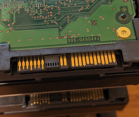

Well, I taped the third pin on all of the disks, and the PC wouln't even power up anymore.

No, the entire machine won't power on with the SAS disks (with the pin taped out) connected.
It's HGST HUS726040AL4210

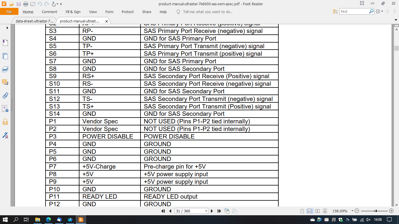

The HGST 7K6000 drives have the power pin disable feature. I just went through this.
From the product manual :

Yeah, how does that help me? I already taped the pin out and it doesn't work to say the least.

When you say you taped pin3 on ALL the drives; do you mean just the SAS drives
Octopuss
Jan 4, 2019
461
Jesus, of course I mean the SAS drives, why would I mess with what's already connected and working?
So, yes, just the SAS drives.

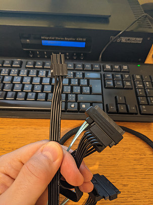

How are the drives connected to the power supply ?
Octopuss
Jan 4, 2019
461
PSU->SATA power cable->SAS cable's SATA connectors->disk
Alecmascot
Mar 18, 2014
1,177
Looks ok.
I would go back to the simplest power cabling with one drive at a time and find the point at which it fails.

The damn PC doesn't power up even with just one of the disks connected.
The cable can't be bad though.
I'll try to get some molex-SATA cables to see if that works, but at this point I'm just lost.
