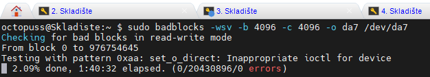

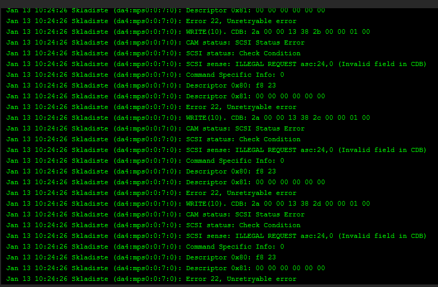

I am running badblocks on four new disks through SSH on my NAS, and the console is constantly spamming this:
The server: TruNAS 12 (latest) running in ESXi, with LSI 2308-based HBA card with passthrough properly configured.
Connected: three SATA disks as the current pool and four new disks that are being tested.
The new disks are SAS HGST HUS726040AL4210.
Badblocks seems to be happily running on all four new disks in parallel.
Does anyone know what these errors are and whether they are harmless or something is wrong?
9,700
From the dmesg output, it seems that da4 is not in good shape.
Stop the badblocks and run a long smart test on it.

I did that before starting badblocks.
This is the output when badblocks is running just one da4. When I run it on all disks, the console output is the same, only the error shows up on all of them. I highly doubt I bought FIVE faulty disks, this must be something else.
Actually I believe I saw similar errors like this in past with the original SATA disks too.
9,700
It could be cabling, the controller or both... check those.
Consider controller firmware too.

Of course you can never be sure, but everything seems to be working just fine. Badblocks has been running for 4,5 hours without problems/errors, disks are obviously operational, SMART doesn't report any errors either... it's weird. I'm inclined to say it's a harmless error, possibly related to the virtualized environment, somehow. It's annoying not being able to clearly identify what's going on though.
9,700
Maybe...
I have a TrueNAS VM in ESXi with a 9300-16i (which is a single card with 2x 3008 chips on it) and I see no such errors.
Your dmesg is certainly not free from errors, so I would feel unsure with my data on that server if I were seeing that.

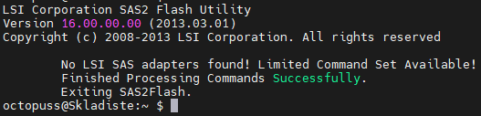

I was trying to remember what card exactly I had, and I googled up this sas2flash program.
But this is weird....
Clearly there IS an adapter in the system, otherwise no disks would even show up.
Alecmascot
Mar 18, 2014
1,177
sas2flash -listall
Octopuss
Jan 4, 2019
461
That's the output of that command, duh.

Octopuss
Jan 4, 2019
461
Oh hold on, it has to be run with sudo. Damnit this Linux stuff is annoying.
Yea it works now.
...but it still only says SAS2308_2(D1). That's not very helpful. But it's not important anyway. It's running the latest FW.

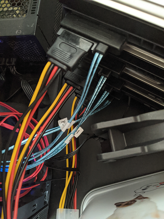

Since you're burning in those disks, the quick option is to swap a cable. If the errors follow the drive, it's likely a bad drive. If it sticks with the cable position...
I plan to order one because of the molex reductions, but interestingly, cables like these are hard to obtain in my country. No idea why.
The current cable also looks fragile as hell.
I mean what the flying fak is this??? I'm afraid to even breathe on it.

Octopuss
Jan 4, 2019
461
I changed the cable and the errors are gone. That's super weird.
