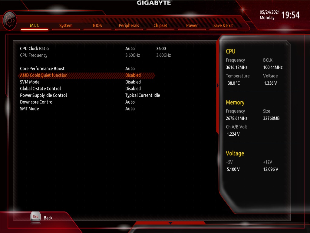

don't know if it's still an issue, but earlier I've seen some posts regarding AMD instability - I believe a lot fixed it by disabling .... C6 state, or something like that in the bios (don't have and amd system to check on)
Starman
15
AMD instability - I believe a lot fixed it by disabling .... C6 state...

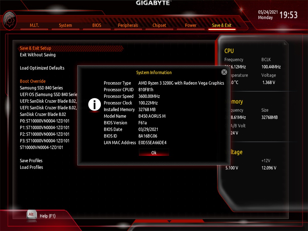

Thanks for the assistance - I've found a post and alter settings accordingly. Scrub is running again should find out soon.
