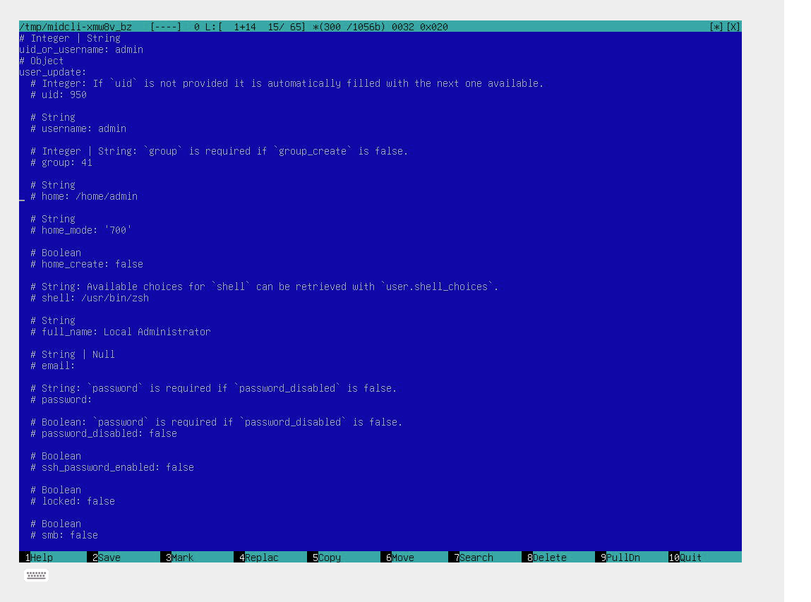

To reset your password for a user:
update uid_or_username=<username> --
on the UI provided uncomment password and enter password you wish to use:
# password:
to password:
Save using F2 and then exit using F10.
