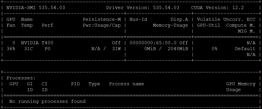

After upgrading to Cobia I cannot pass my GPU to Plex app anymore.
This worked fine in Bluefin(last version: 22.12.4.2)
On the drop sown menu there is no GPUs available to choose.
nvidia-smi sees the GPU:
