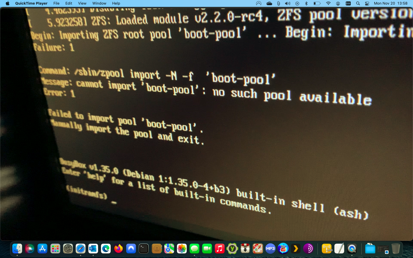

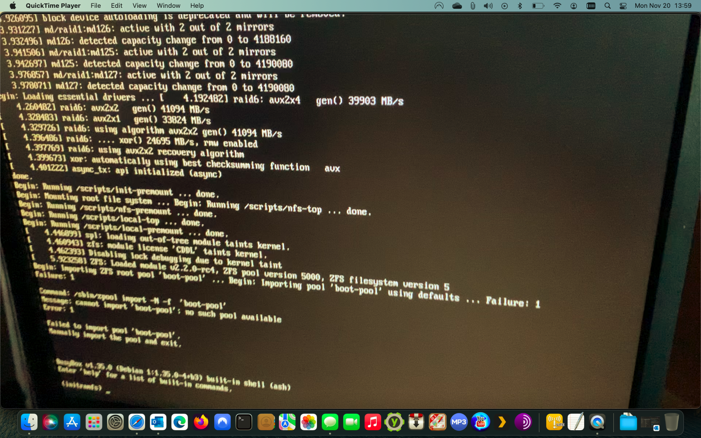

Last week I tried to upgrade to Cobia from latest Bluefin using the upgrade train in the GUI.
Once all done, the system fails to boot.
Boot process start anomaly, then exit to initramfs prompt when trying to import pool 'boot-pool'
Begin: Importing ZFS root pool 'boot-pool' ... begin: Importing pool 'boot-pool' using defaults ... Failure: 1
Command: /sbin/zpool import -N -f 'boot-pool'
Message: cannot import 'boot-pool': no such pool available
If I type /sbin/zpool list
I get:
no pool available

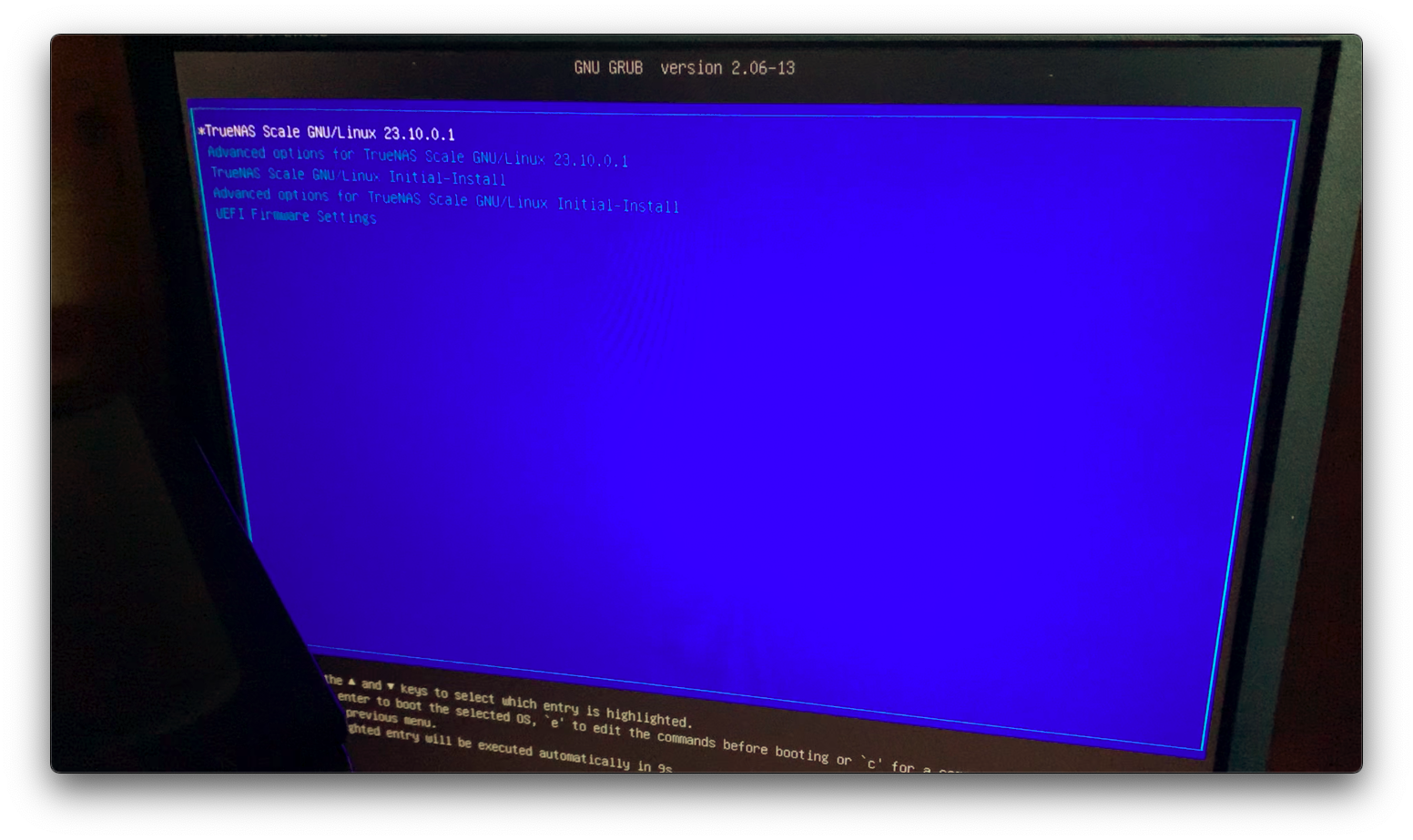

That's most likely the root cause of the issue here. We don't recommend USB boot media these days, odds are the device isn't initializing as fast on the new kernel for whatever reason. Let me ask, where does it hang? Does the kernel load, or is it failing at the grub loader itself?
It might be possible via GRUB to add a rootdelay setting to make it wait longer:

Could you specify me in which config file I should add the rootdelay=10
In the mean time, I'm uploading a video of the boot in Cobia.
You will see were it hang with all the message.
