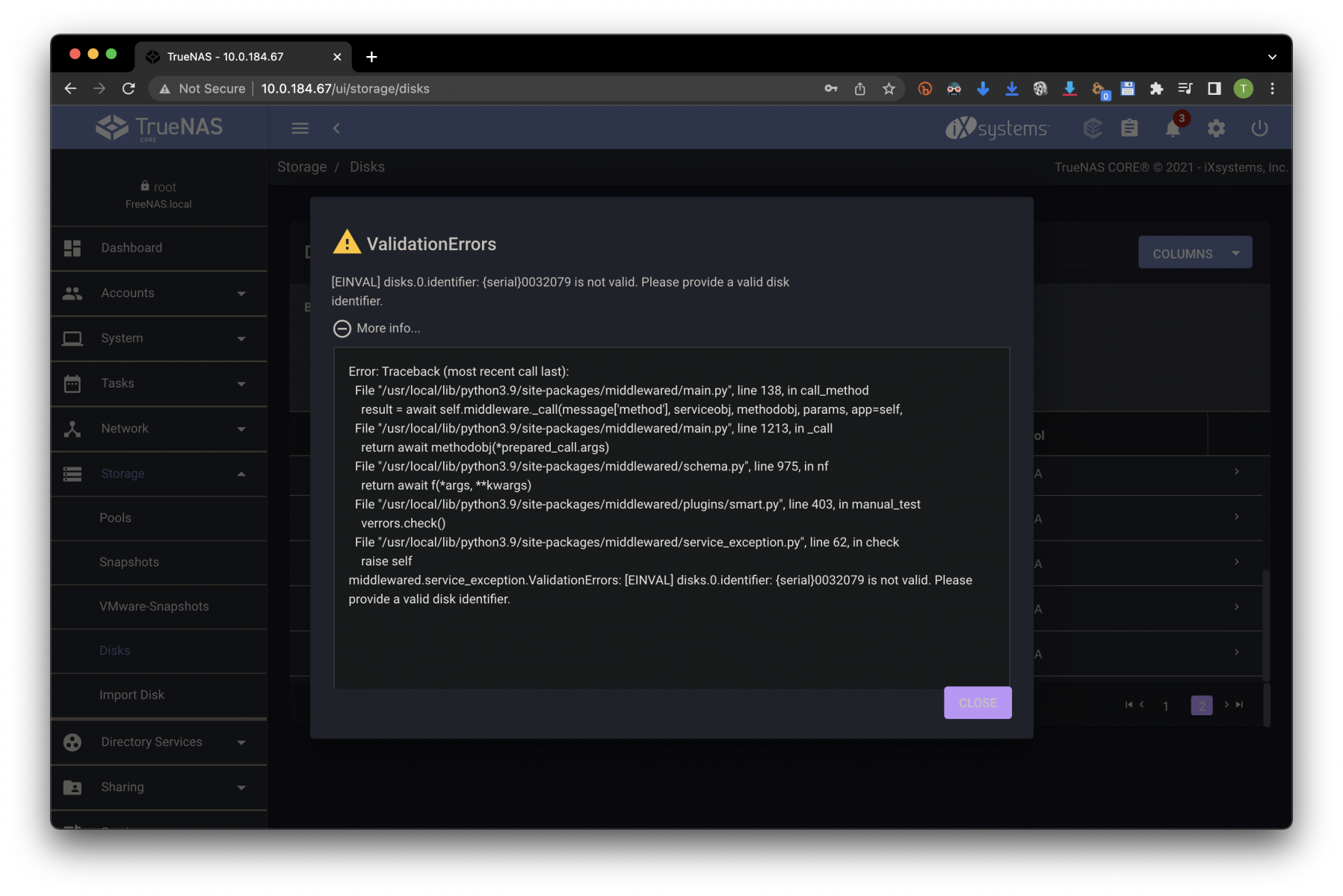

The error message ist:
result = await self.middleware._call(message['method'], serviceobj, methodobj, params, app=self,
  File "/usr/local/lib/python3.8/site-packages/middlewared/main.py", line 1195, in _call
  File "/usr/local/lib/python3.8/site-packages/middlewared/schema.py", line 973, in nf
  File "/usr/local/lib/python3.8/site-packages/middlewared/plugins/smart.py", line 398, in manual_test
    verrors.check()
  File "/usr/local/lib/python3.8/site-packages/middlewared/service_exception.py", line 62, in check
    raise self
middlewared.service_exception.ValidationErrors: [EINVAL] disks.0.identifier: Test cannot be performed for {serial_lunid}XXXXXXXXXXXXXXXXXXXXXXXXXXXXXXXXXXXXXXXXXXXXXXXXXXXXXXXXX  disk. NVMe devices cannot be mapped yet.
[EINVAL] disks.0.identifier: Test cannot be performed for {serial_lunid}XXXXXXXXXXXXXXXXXXXXXXXXXXXXXXXXXXXXXXXXXXXXXXXXXXXXXXXXX. Unable to retrieve disk details.

I upgraded my TrueNAS system to TrueNAS-12.0-U5 today, but when i do a manual smart test in the Web GUI i still get an error message, see below:
In the console i get at least a working and meaningful output, even if NVME disks are experimental in smartctl:
smartctl -t short -d nvme /dev/nvme0
smartctl 7.2 2020-12-30 r5155 [FreeBSD 12.2-RELEASE-p9 amd64] (local build)
Copyright (C) 2002-20, Bruce Allen, Christian Franke, www.smartmontools.org
NVMe device successfully opened
Use 'smartctl -a' (or '-x') to print SMART (and more) information
But the web gui still selects the wrong disk identifier when trying to do a manual test and gives an error message:
[EINVAL] disks.0.identifier: {serial_lunid}XXXXXXXXXXXXXXXXXXXXXXXXXXXXXXXXXXXXXXXXXXXXXXX is not valid. Please provide a valid disk identifier.
More info...
  File "/usr/local/lib/python3.9/site-packages/middlewared/main.py", line 138, in call_method
  File "/usr/local/lib/python3.9/site-packages/middlewared/main.py", line 1205, in _call
  File "/usr/local/lib/python3.9/site-packages/middlewared/schema.py", line 973, in nf
  File "/usr/local/lib/python3.9/site-packages/middlewared/plugins/smart.py", line 402, in manual_test
    verrors.check()
  File "/usr/local/lib/python3.9/site-packages/middlewared/service_exception.py", line 62, in check
    raise self
middlewared.service_exception.ValidationErrors: [EINVAL] disks.0.identifier: {serial_lunid}XXXXXXXXXXXXXXXXXXXXXXXXXXXXXXXXXXXXXXXXXXXXXXX is not valid. Please provide a valid disk identifier.
In my opinion this is a bug. It should at least select the correct disk identifier and say something meaningful like smartctl doesn't support testing of NVME devices.

NugentS
Apr 16, 2020
2,947
Doesn't seem to run on Optane's either
    verrors.check()
    raise self
middlewared.service_exception.ValidationErrors: [EINVAL] disks.0.identifier: {serial}PHMB742301HB280CGN is not valid. Please provide a valid disk identifier.
Given how important the Optane's are likley to be - this is a little concerning

Seriously. While I'm in no position to criticize people fixing things I don't understand, I think I'm still having this issue now.
Revan
Mar 22, 2017
81
The bug still exists in TrueNAS-12.0-U8 when i click on Storage -> Disks and when i select my nvd0 device (mark the checkbox).
Then i can still run a manual test and this will result in the error message, i mentioned above.
It's only fixed for the right arrow button "expand/collpase row", there the manuel test doesn't show up for this device.
