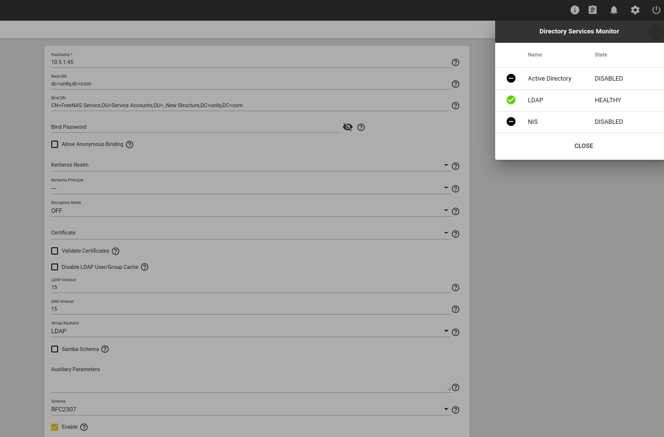

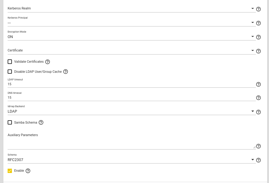

Currently the LDAP plugin just times out even if i set the timeout for ldap and dns to a higher number. If there is something I can do to help troubleshoot this I'm all ears. We are using Azure Active Directory, like I said this all works whenever I revert back to 11.2 however because of various reason I can't stay on that version. The settings I'm using are all identical from 11.2 to 11.3 @anodos
hemlock
Feb 24, 2020
10
Currently the LDAP plugin just times out even if i set the timeout for ldap and dns to a higher number. If there is something I can do to help troubleshoot this I'm all ears. We are using Azure Active Directory, like I said this all works whenever I revert back to 11.2 however because of various reason I can't stay on that version. The settings I'm using are all identical from 11.2 to 11.3 @anodos View attachment 36245
So when I change settings to point at a internal server not using ssl it works just fine.
As I've already mentioned, this particular forum thread is about issues involving AD. You're using the LDAP plugin. There are several bugfixes related to the LDAP plugin in the 11.3-stable branch on github. https://raw.githubusercontent.com/f...e/src/middlewared/middlewared/plugins/ldap.py. You can try cloning your boot environment, replacing /usr/local/lib/python3.7/site-packages/middlewared/plugins/ldap.py with the version attached, and then issuing "service middlewared onerestart". If your problem persists and you don't see a corresponding bug ticket in our bug tracker, you are welcome to file one there.
