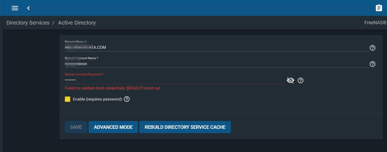

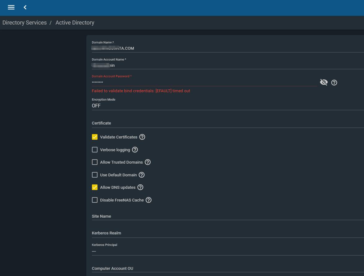

Can't join Active Directory,Failed to validate bind credentials: [EFAULT] timed out
freenaslol
Feb 13, 2020
5

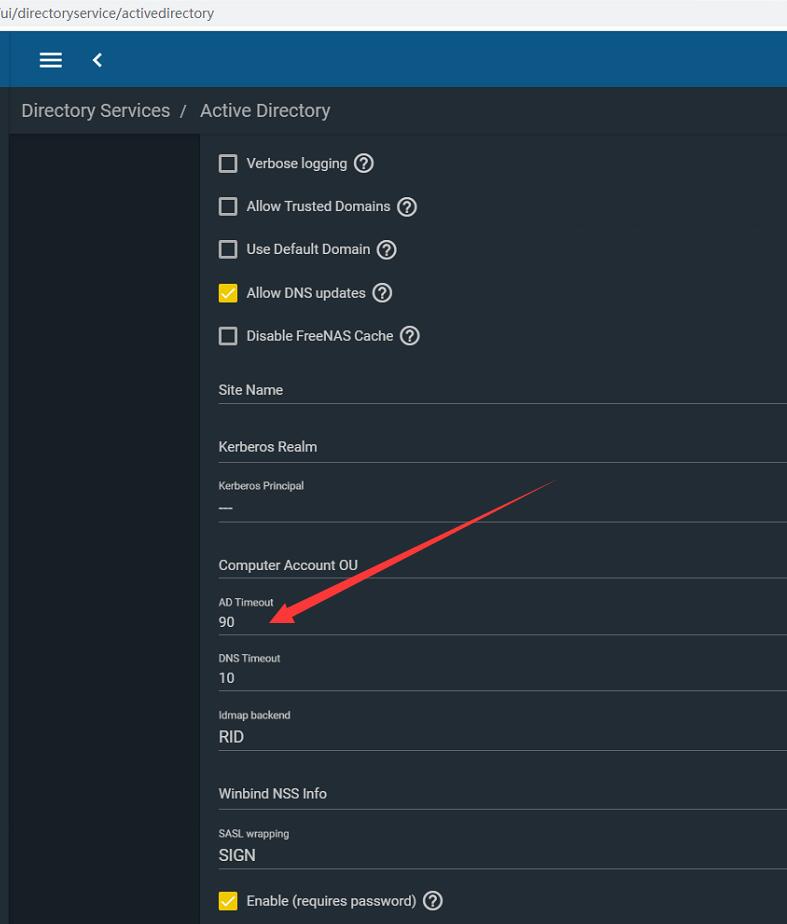

FreeNas 11.3 new install;
ESXI 6.5 ENV;
Windows 2012 R2 AD;
AD time out up to 90;
AD Account is correct;
ping AD Server is OK; ping NAS's HostName(xxxx.domain.com) is OK;
Does anyone know why?

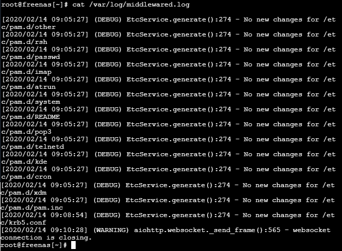

Hi, anodos

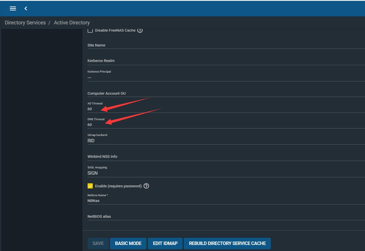

AD Timeout, DNS Timeout up to 60;
The problems remain ;
[2020/02/14 11:16:10] (DEBUG) EtcService.generate():274 - No new changes for /etc/krb5.conf
[2020/02/14 11:28:55] (DEBUG) EtcService.generate():274 - No new changes for /etc/krb5.conf
[2020/02/14 11:30:33] (DEBUG) EtcService.generate():274 - No new changes for /etc/krb5.conf
[2020/02/14 11:31:13] (DEBUG) ServiceService._simplecmd():287 - Calling: start(ssh)
[2020/02/14 11:31:13] (DEBUG) EtcService.generate():274 - No new changes for /etc/local/ssh/sshd_config
[2020/02/14 11:31:40] (DEBUG) ServiceService._simplecmd():287 - Calling: reload(ssh)
[2020/02/14 11:37:19] (DEBUG) ServiceService._simplecmd():287 - Calling: start(lldp)
[2020/02/14 11:37:34] (DEBUG) EtcService.generate():274 - No new changes for /etc/krb5.conf
[2020/02/14 11:37:40] (DEBUG) EtcService.generate():274 - No new changes for /etc/krb5.conf
[2020/02/14 11:38:06] (DEBUG) ServiceService._simplecmd():287 - Calling: stop(lldp)
[2020/02/14 11:39:02] (DEBUG) EtcService.generate():274 - No new changes for /etc/krb5.conf
  • middlewared.zip

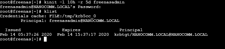

Is it posible to get a kerberos ticket ? : kinit freenasadmin
Whats about firewall related problems ?
Is the ESXi in the same network / VLAN than the AD or do you use NAT ?
acarmona
Feb 13, 2020
8
This is correct?
The servers share the same VLAN.
My english is very bad, sorry.

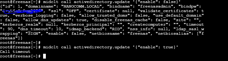

Turn on "verbose logging", and run the following commands:
midclt call activedirectory.update '{"enable": false}'
midclt call activedirectory.update '{"enable": true}'
and upload the middlewared log.

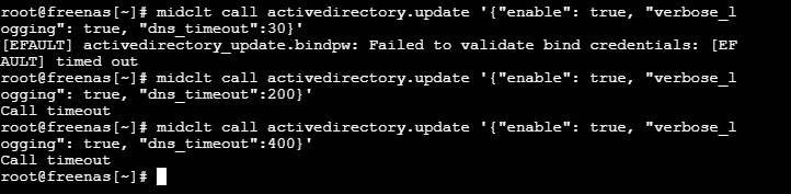

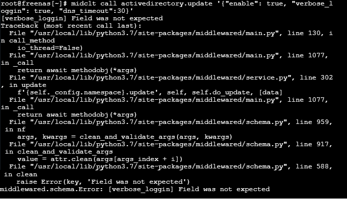

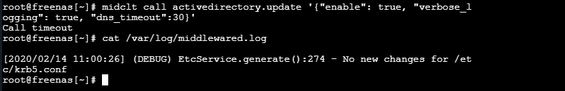

Try the following:
midclt call activedirectory.update '{"enable": true, "verbose_logging": true, "dns_timeout": 30}'
This looks suspiciously like we're hitting the a timeout for middleware calls. If this is the case then it looks like the environment is taking over 60 seconds complete an LDAP bind. You may want to also review logs on your AD DC.
