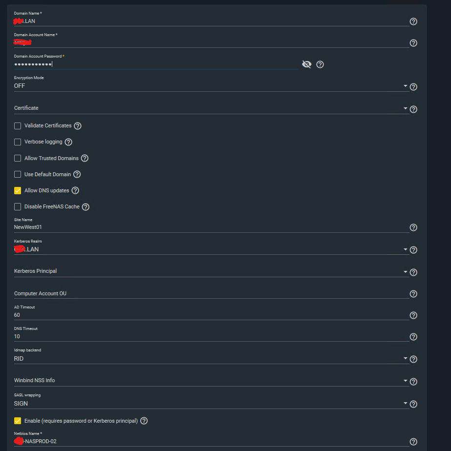

I did have issues joining my NAS to the Windows Domain as well, I had to set DC as my NTP, regardless of time being the same with the freebsd provided NTP, it still would time out. So definitely worth trying.
FWIW, settings are attached that worked.

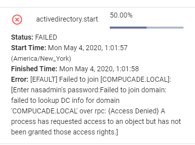

I am also hung up on joining to domain using active directory service.
New test Windows server 2019 standard. I was able to install windows 10 and join to the domain with no issue.
I confirmed Freenas has correct DNS and can ping AD server (Both FQDN and just the domain) I also confirmed the time is with-in the same minute between Freenas and PDC. I get the alert faulted as you mention above, but I am also getting the following error in Event Viewer in windows server(see below). If I change the way I add the account setting in freenas I get an error right away that it can't login where the other way excepts my input, so I assume it is correct. Any help is appreciated.
An account failed to log on.

Gremlin
Jun 30, 2018
10
What is the error you get on FreeNAS if you set the username and password correctly?
Is the Windows Time service running on the server?
Can you try using Shell in FreeNAS to sync time with the server? If you run into issues, try disabling the firewall as a first test.

This indicates that we tried to use an account associated with the AD computer object for our server (hence the server name followed by the "$"). The account didn't exist in AD and so it failed. U2.1 can get stuck in this state due to stored credentials in samba's secrets.tdb. A typical case where this might happen is someone joins AD, encounters an issue, and in troubleshooting decides to delete the AD computer object and re-join AD. It will be fixed in 11.3, but in the meantime try the following:
1. Disable AD
2. Remove AD_MACHINE_ACCOUNT kerberos keytab on FN server
3. rm /var/db/system/samba4/private/secrets.tdb
4. net cache flush
5. Enter credentials in AD form and enable AD service.

I appreciate the response, It has fixed that error in EV in windows, but still can not connect to AD. I am now seeing the following error in FN
It seems to be a "permissions" issue I just not sure where to look. So far EV and FW logs looks clean.
Finally, I tested with another AD account and it worked. From there I created a new data set and SMB share and so far so good. I am so excited. Thank you @anodos for your solution. Your solution on my initial error let me continue to move forward and figure out my issue.
Thanks again
