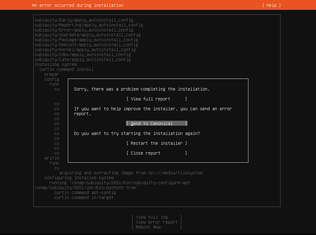

I have tried 2 servers, one a Lenovo Think Server t40 and the current one is a Cisco m3 220 Dual Xenon with 256GB RAM, 500GB SSD Boot TrueNAS and 1tb x2 SSD for drive pool.
I can install and run perfectly Ubuntu 20.04 Desktop, but when trying to install Server (18.04 or 20.04) both halt the install after selecting all default options, no addons and 10GB drive, 32GB RAM, 2 vCPUs, 2 Cores, 1 Thread. Errors out and crashes with full control to reboot with "Sorry, there was a problem completing the installation."
Nothing jumps out in the logs. I have followed many tutorials and nothing seem to work.
Fail: Curtain command in-target
curtain: Installation failed withe the exception: Unexpected error while running command.
Any help?

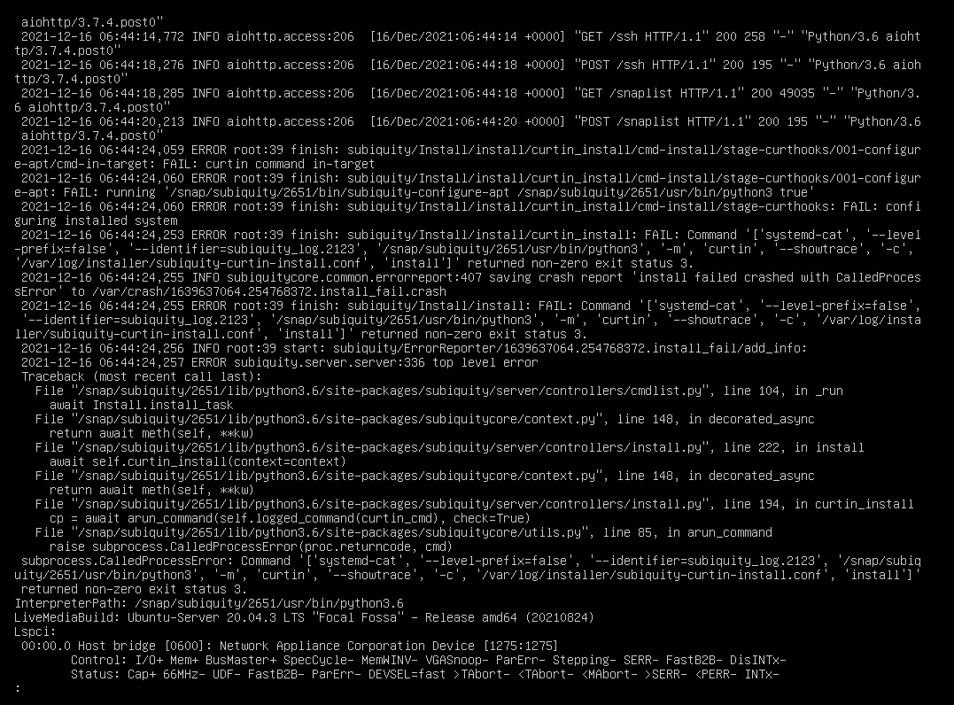

End of the log doesn't have anything sexy, but I found this in the middle of it, somewhere.

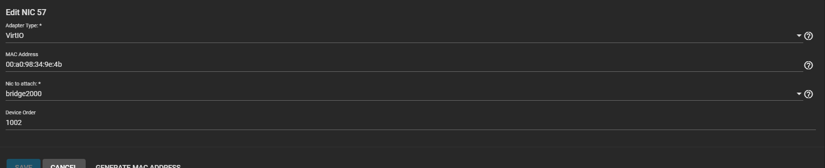

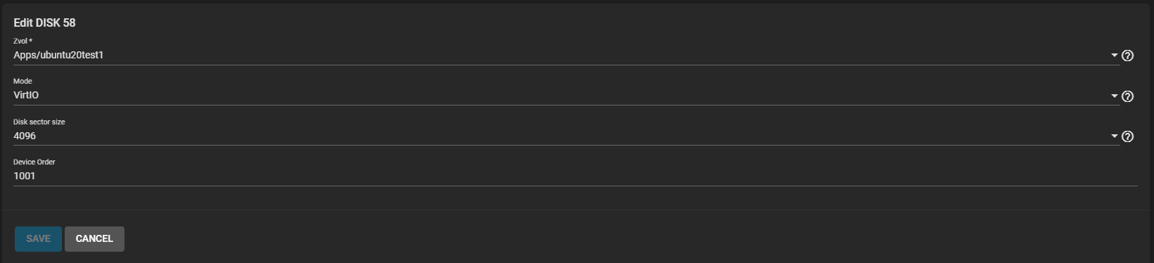

Did you create both disk and network virtual devices as VirtIO?
Vertigo 7
May 8, 2021
78
yes
I've played around with different configs on mode and sector size of the disk. even manually created a couple of zvols in different pools (SSD and CMR). same results.
