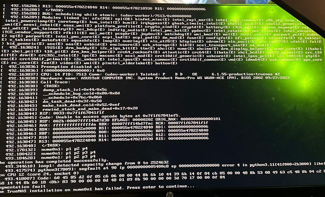

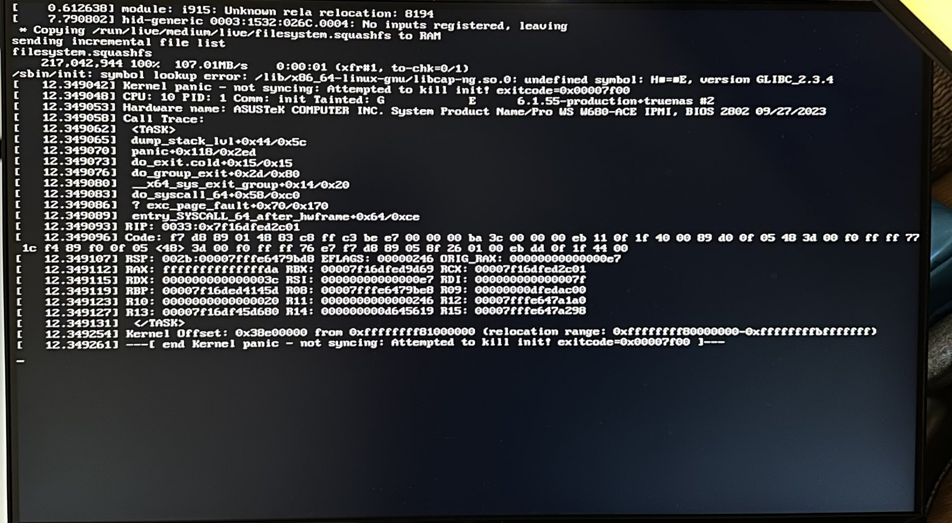

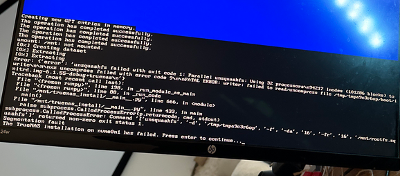

I keep trying to install either TrueNAS Scale (or Core to then try to upgrade on Scale), but I can't, I keep having multiple issues... Here is the following screenshoots of the different problems :
Thanks you !

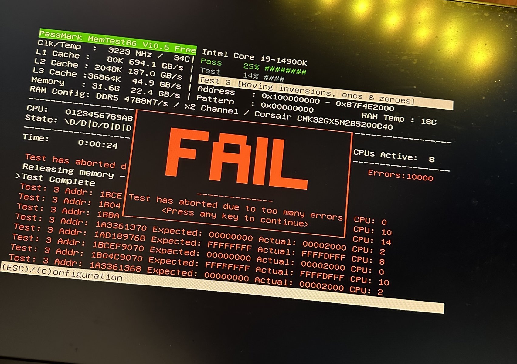

I'll see to run the MemTest and keep you informed. Also, I'm using 2 PCIe cards : one with 16 SATA slots which is not a RAID card (12 HDD are connected on it and the resting 4 are connected to the motherboard) and the other is a 10 Gbps Ethernet card.
EDIT : I just ran the Memtest and I got this in a few seconds :

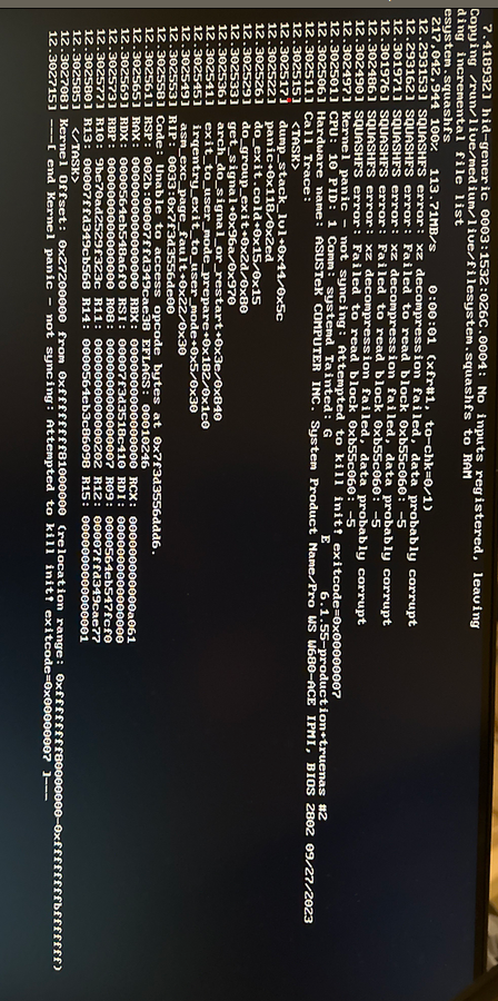

Now, I'm testing the RAM individually.
One of the individual test :
And the other one :
joeschmuck
Old Man
May 28, 2011
10,994
I can't boot on any disk if there is nothing on them... So I'm not sure what you're asking me ? To install my NVMe on another machine in order to install something on it which should allow me to boot on it ?
I was asking for you to disconnect all the drives in your system except the boot drive. You can bootstrap TrueNAS without any pools attached and it should start up just fine, but without any pools of course. This is one test. HOWEVER, I think you have found your problem.
My advice for troubleshooting the RAM failure is:
1) In the BIOS, restore to BIOS defaults. Retest and hope it passes.
2) Any overclocking can result in this type of failure, as well as a poor power supply. Recheck your power connections and if you have a spare power supply, try that out.
3) Unplug any add-on cards, disconnect the hard drives power, get to a very basic motherboard, keyboard, monitor, and boot drive (MemTest86), nothing else. Run Memtest86 again, if it fails you may have incompatible RAM for your motherboard or a bad motherboard or a bad power supply.
4) One other possible failure is the CPU. The CPU interfaces with the RAM and is just another piece but I rarely see the CPU as being the problem.
These things are not fun to troubleshoot however the one thing going for you is the failure happens quickly. Imagine if a failure didn't happen until 10 hours into the test. Make sure your RAM is on the QVL for your motherboard.
Memory controller is on the CPU so it could be the issue. Highly unlikely but still a possibility.
