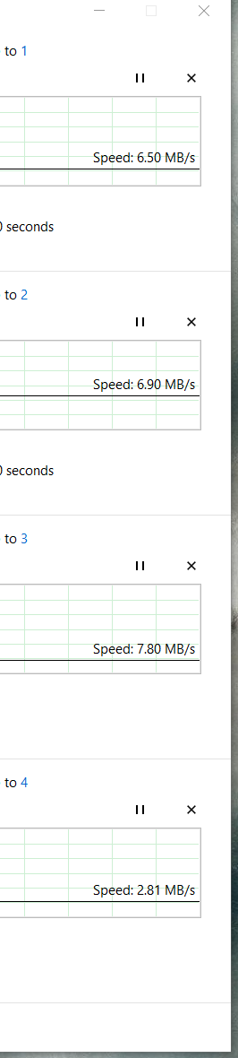

If I set off multiple (4) small file copies at the same time again it took windows a hell of a long time to get sorted I got he following
It looks to me that you are running into an SMB limitation - either on the server or on the client. Note that I have a 10Core CPU (E5_2660V3) on the NAS and a Ryzen 9 5900X on the client. The NIC wan running at a combined 250-330 Mbps
