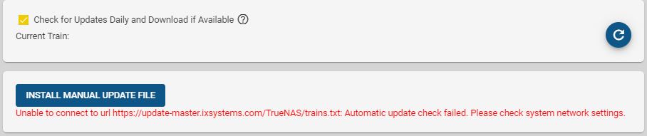

I'm running TrueNAS-12.0-U2.1, and I can't seem to get the updates to work it does not even show train version on it.
this is the error it gives me
"Unable to connect to url https://update-master.ixsystems.com/TrueNAS/trains.txt: Automatic update check failed. Please check system network settings."

The error message tells you whats wrong. Check and fix your network settings.

Thank you. I never changed the settings on the server before it stoped working but forgot spectrum had replaced the equipment in the office. so had to change the gateway from "192.168.0.1" to "192.168.1.1" on the server
