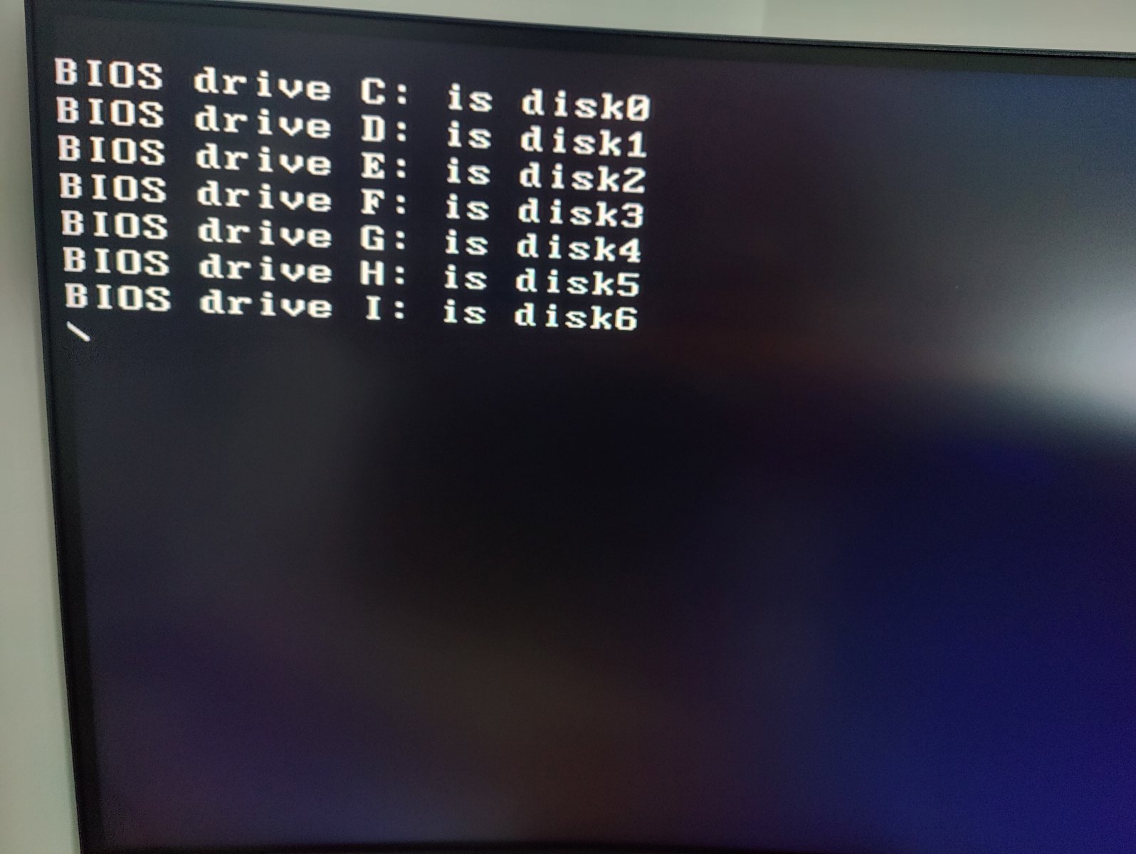

Since I added disks to this array after a reboot, I have Truenas that freezes on a disk listing screen and does nothing.
If I disconnect the bay from the server, it boots normally. To spare you the details, I noticed that the numbering of the disks was changed when I plug in the bay.

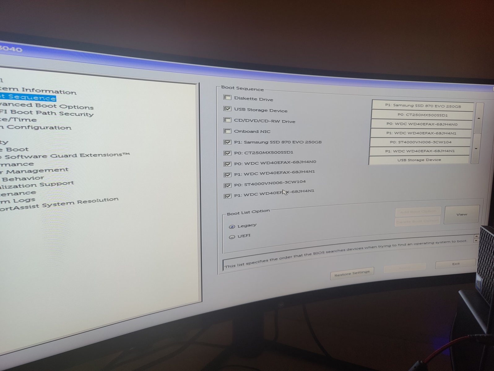

It's possible. Assuming I'm correct in my assessment of the card from the QNAP website [1] it's going to present the drives as SATA devices, so if there's a BIOS on the QNAP card it might be trying in vain to boot from those disks, or somehow otherwise confusing the Optiplex.
Can you compare the Optiplex BIOS with respect to "boot order" and "SATA devices" when booting to BIOS with the bay attached vs disconnected? Checking for and disabling the "PCI Option ROM" for the add-in card (or "cards" if it shows as two devices) might also help here.

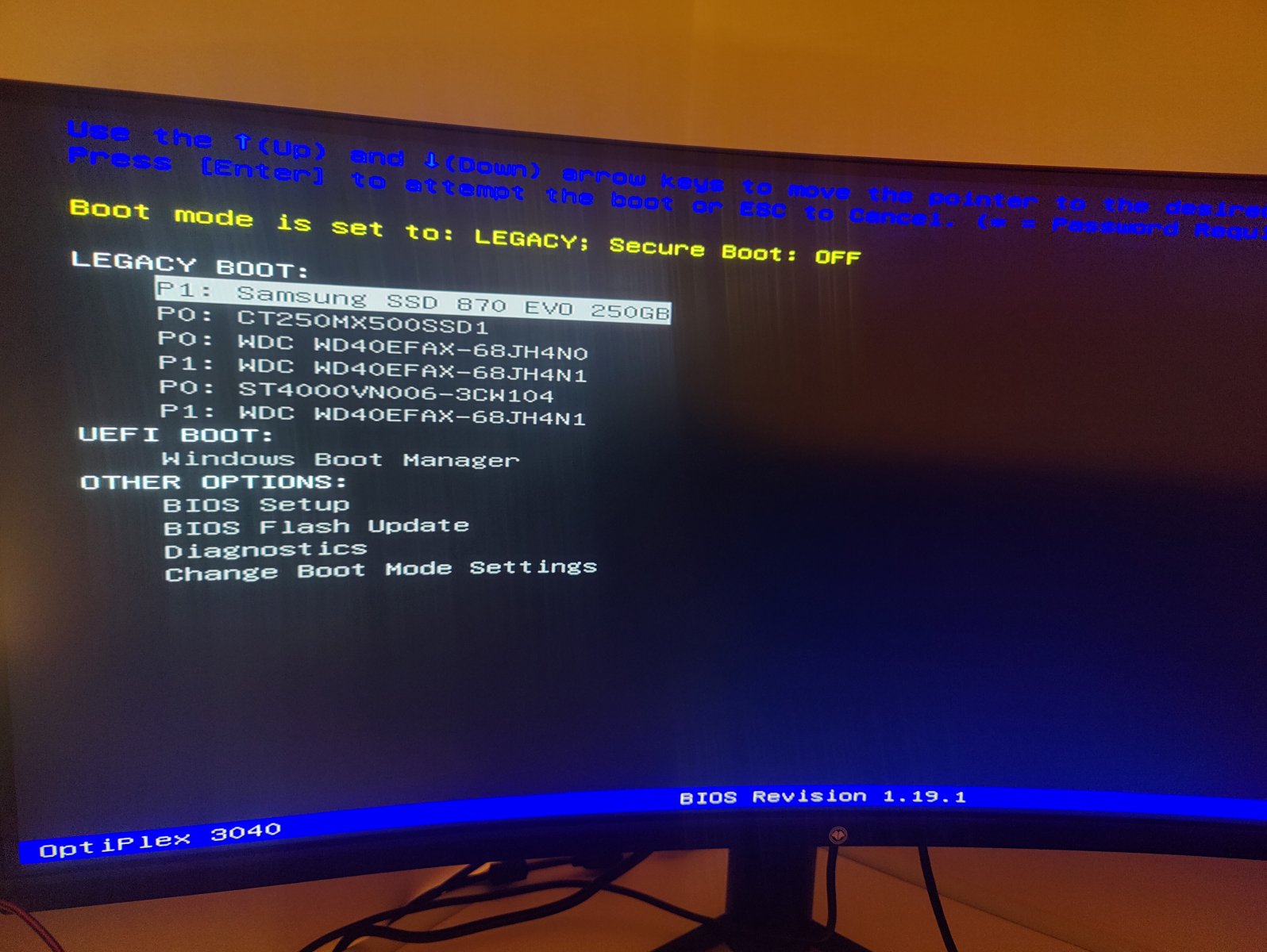

you can see my display when the bay is plugged in : (Samsung ... and CT250MX500 ... 2 SSDs that contain the mirrored system.)
In the boot sequence options, I have chosen the SSDs first but not working.

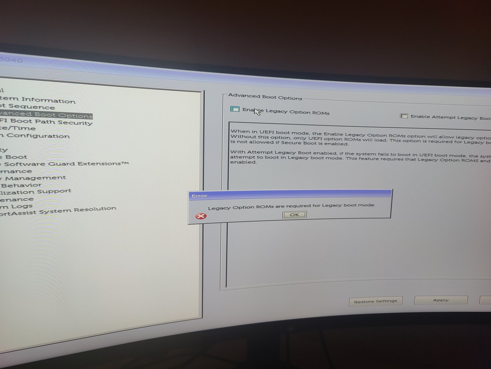

I don't know if it's this option but I can't disable it because I have TrueNAS installed in Legacy mode.
if I try to boot on the Truenas with USB bootable in legacy mode it also blocks but if I boot in uefi mode it works.
Reinstalling TrueNAS in UEFI mode solve this problem ?

A bigger problem I see though from your BIOS images is your hardware - three of your four 4TB drives are WD40EFAX which are known to use shingled magnetic recording or "SMR" - these drives specifically have firmware compatibility issues with ZFS that can cause them to fail during heavy writes, including during resilvering ("rebuild") operations.
You should try to plan for their replacement.

I reinstalled TrueNAS in UEFI mode by choosing the upgrade option.
I deactivated the legacy rom option in the bios and it works.
