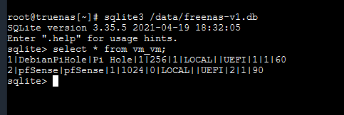

OK, I apologize for the misidentification. There's something funny going on with that VM's entry in the configuration database. The errors KeyError and Unable to locate domain indicate a problem in the configuration database file /data/freenas-v1.db table vm_vm. Can you run sqlite3 /data/freenas-v1.db, and then SELECT * from vm_vm;, and report the output?

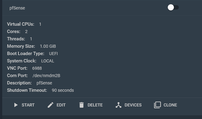

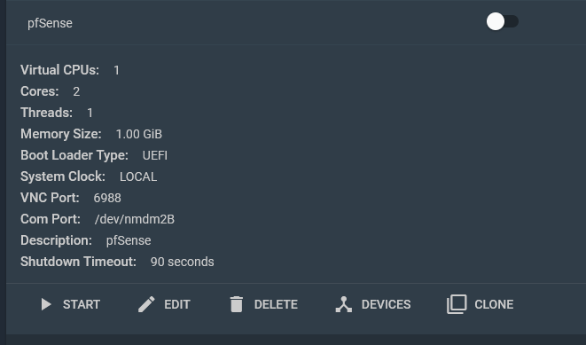

That's what I thought. You have a mismatch between the UI and the DB. The DB thinks your VM name is pfSense, but the UI thinks it's pfSenese (2nd column after the VM ID).
I'm not in front of my system currently, but I did mock up the SQL commands to fix this. When I get home tonight, I'll post the specific SQL commands to fix this. We'll need to make the DB match the UI, so the UI will be able to resolve the KeyError.

No... we changed the name a few troubleshooting steps back if you check the more recent error messages I posted it has been trying to start 'pfSense' and failing in the error messages. I attempted to ensure that all the correct settings matched between the 12 and 13 boot environment by just deleting my 13 boot env and re upgrading this ended up resulting in the same error.
Ultimately removing PCIe passthroguh and rebooting got it booting again... but now I can't add my PCIe devices back.

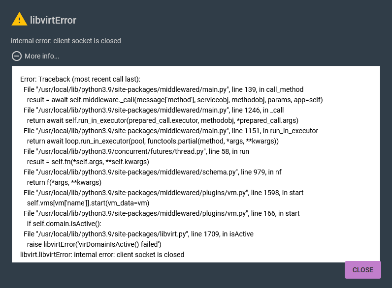

The PiHole VM ends up inaccesaible from the GUI also after awhile I get this after tying to start it (its set to autostart so should already be running, and is running after a fresh reboot... after awhile it ends up like this).
