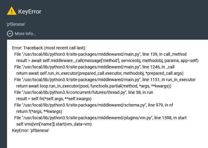

I rolled back my install to 12.0-U8.1 and it continued working as it had.
I have 2 VMs a pi-hole VM and a pfSense VM with ports passed through to the latter.
The Pi Hole VM works now in 13.0-U2 but the pfSense VM still fails to boot. And yes I am aware that pfSense is misspelled... but that should not be why it fails since it works fine in 12.0.

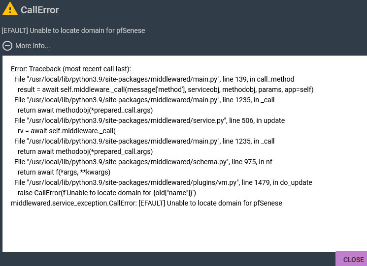

It also fails to edit the VM configuration.

Could it be related to VNC settings? The bhyve args for VNC changed between FreeBSD 12 & FreeBSD 13, and when first upgrading to TrueNAS 13 I did have to adjust my scripts to pass them correctly, because otherwise I wouldn't have VNC into my pfSense VM. I did start successfully, though, but without VNC, and it wouldn't surprise me to see the TrueNAS middleware throwing an exception because of that.
cb88
May 11, 2022
24
No they fixed that bug, and it was preventing PiHole from starting.
If you look at my original comment here, you can see that the middleware is falling flat on it's face for some reason.

OK, it was worth a shot ;) Where does following that Python stack trace take you?

Please report the output of midclt call vm.query | jq. The error indicates a name mismatch.

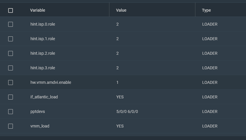

Are your passthrough tunables still in place?
